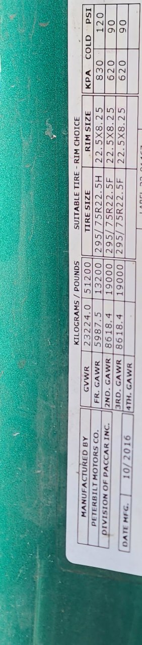

    See paragrapgh I section 1 and 2. Basically whatever the minimum cold rated pressure for the load is is your minimum. To find this info see your owners manual or the sticker on your door. For example.
    For example here you can see what the cold pressures will be for each tire rating for a given size. In sure someone has one for 24.5s and such but in my case running F tires it would be 90 PSI instead of the 110 i keep them at. Or at least that is how I as someone who is NOT a lawyer understands it.
    That said best practice is to add more at 95 PSI and they will generally speaking leave you alone.

  5. Arctic_fox
    4,604
    26,354
    Sep 16, 2016
    Yes and thats listed on my sticker namely for 19000 pounds on an F rated tire its 90 psi, which is why i said it the way i did.
    That said most manufacturers i checked dont have a list i can FIND keyword veing find that rates tire psi per load weight save max and max. I.E

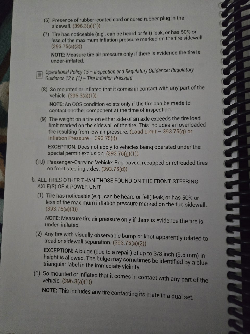

  10. brian991219
    brian991219 Road Train Member
    3,032
    6,236
    Aug 10, 2013
    Lords Valley, PA
    393.75 covers tires. There are two areas that can cause problems with inflation. The first is operating below the minimum cold pressure for the load (weight) being carried by the tire. The other is the CVSA Out of Service criteria which is found in their published guide (not available unless you buy it from them) which is where the 50% rule comes from.
    For a tire to be placed OOS due to being "flat" it must have an noticable air leak (heard or felt) or has 50% or less of the maximum inflation pressure as show on the tire sidewall. For more information see CVSA Operational policy 15.
    Here is a picture of their 2021 OOS guide, although they replace the guide yearly in April this is still accurate. I just don't have my 2024 guide with me today.
    Albertaflatbed and omaharj Thank this.
  11. Lyle H
    Lyle H Road Train Member
    1,292
    2,943
    Apr 16, 2014
    There is no maximum pressure listed on the sidewall. Only minimum pressure required to haul specified weight.
    Only the rim has a maximum pressure rating.
