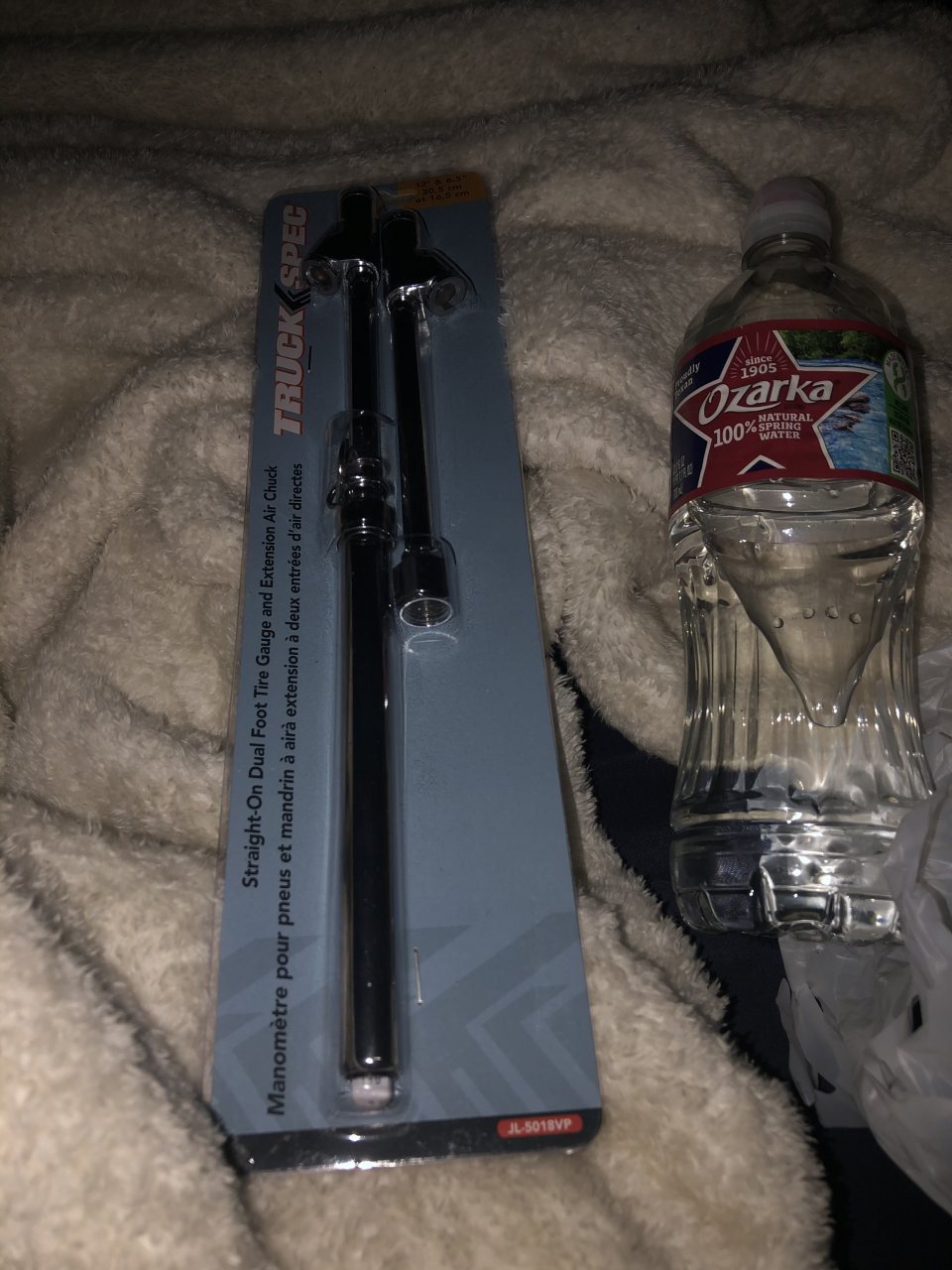

  4. farmerjohn64
    6,383
    38,746
    Jun 25, 2019
    Appreciate it, I just picked this up to check 6BB3F55F-B8DD-4CFE-89F2-0EE00179C743.jpeg

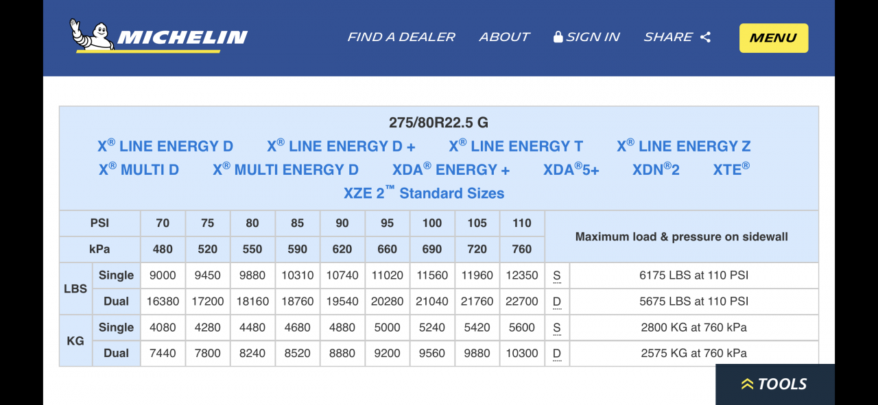

  7. PE_T
    PE_T Road Train Member
    120 on steers only if the sidewall states 120 COLD psi. Most truck steer tires probably have the standard 110 COLD psi printed on the sidewall.
    Technically, the COLD psi printed on the sidewall is the maximum you should have in it while the tire is cold, say, has not been driven for over 4 hours and has been away from direct sunlight preferably. If you have a standard 110 COLD steer tire, you can use 100 to 110 psi cold. Go with 110 cold if you haul heavy most of the time. Go with 100 if you haul mostly light loads. Otherwise, you might experience over-inflation tire wear.

  9. otherhalftw
    otherhalftw R.I.P.
    13,081
    45,332
    Nov 18, 2008
    CA...gold discovery foothills
    Check your tire guage, most of them are not calibrated well if at all. It will give you a decent "ball park" reading though.
  10. uncleal13
    uncleal13 Road Train Member
    3,797
    6,299
    Apr 9, 2009
    Humboldt, Sk
    Not correct. What is printed on the side of a class 8 truck Tire is the maximum weight the tire can carry for a given air pressure.
    Or conversely it means the minimum pressure for a given load on the tire.
    The absolute maximum pressure is stamped on the rim. The tires can handle way more pressure before the rim folds over.
  11. PE_T
    I had this discussion in the past somewhere in this forum. The truth is that while the tire does not specifically state a maximum psi, it is “understood” that way from load and inflation tables, say, from Michelin. If a Michelin steer tire has 110 psi stamped on the sidewall, then the load and inflation table for that tire will ONLY give you psi readings up to that point. See image below. That’s the tire size I currently have on my trailer and steers.
