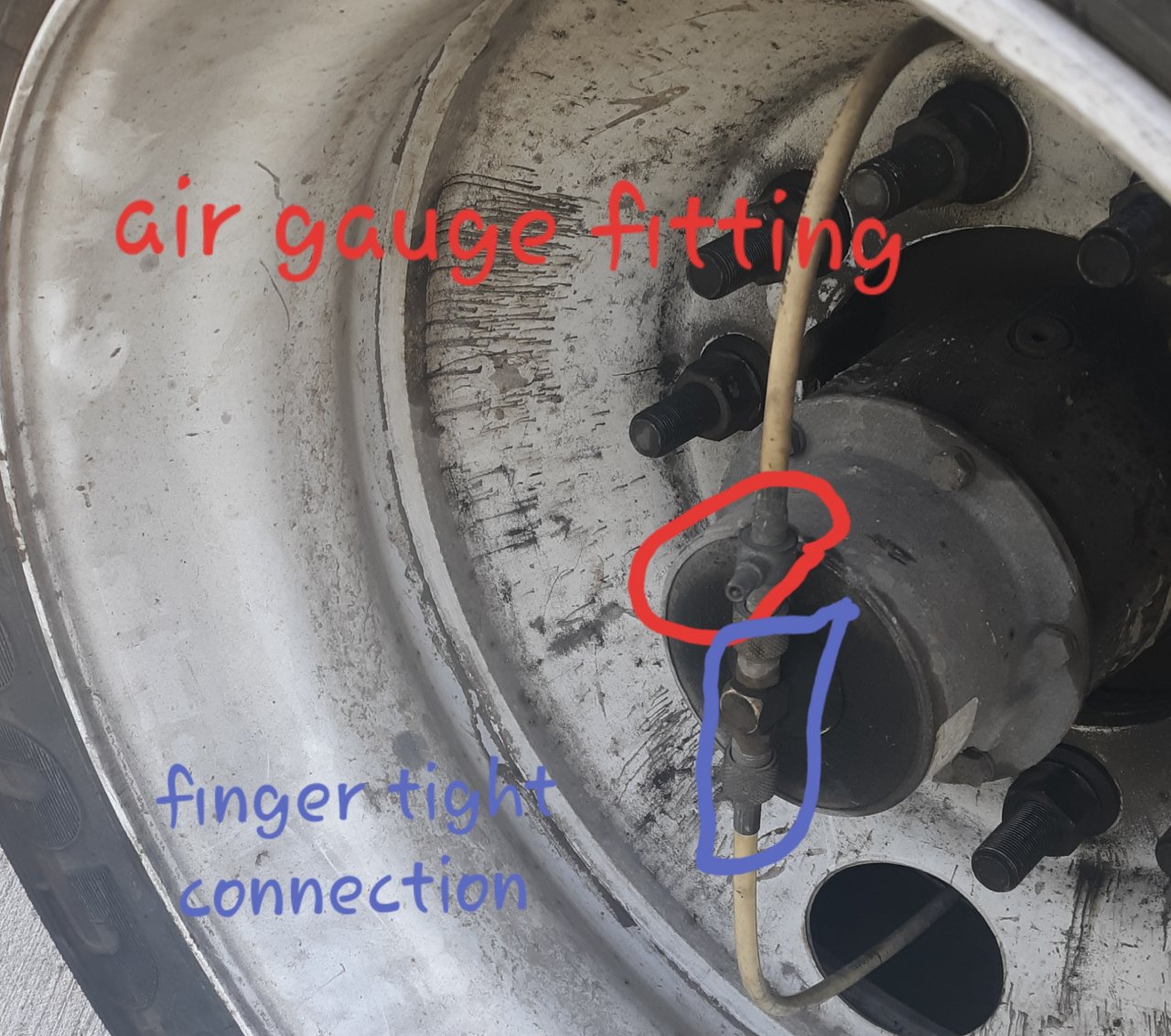

    This morning daylight shows I've got 1 hub with a fitting to check the outer tire, but no fitting for the inner tire.
  9. Qbf594
    Qbf594 Road Train Member
    1,642
    8,715
    Aug 15, 2019
    Southern Canadian annex, NY
    And a easier view of 2 gauge fittings, and 2 air line connect fittings that IMO you should give a quick check when you get a new trailer. I picked up a preload from Aliquippa PA that had 1 of these loose. By the time I was in Hebron oh an outer tire was flipping around on the rim. TA managed to screw everything up including the rim but I was sent on my way 5 hours later. They suggested that I had rolled the tire off on a curb. And Aliquippa has those rotten curbs and I left at 3am...so it was plausible.
    Next morning I see it's fubar... again. I drove it like that. Probably stupid but I was almost able to make the appointment in St Louis so I ran it like that and went to a local tire shop after I delivered.
    The TA never checked the air supply to the tire. That brass fitting was loose and it slowly lost air until it unbeaded itself.
    Rolling detached from the rim for 200 miles destroys the structural integrity of the tire.
    So...2 tires, 1 rim, 7 hours, risk of DOT displeasure....
    I check that fitting now.

    Since there is an inflator system there, is it possible the one fitting would measure both?
