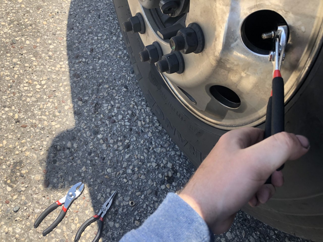

    Well that was hot as hell to walk on; I think I figured it out just from looking at it 0A6CB38A-42C0-4E39-9938-765C24A690A4.jpeg

    Start carrying some tools with you when you get back home. Screw drivers, wrenches, pliers, socket set, hammer for banging in stubborn sliding tandem pins in when they're stuck. Those few things will go a long way for you in case you need them for minor repairs like putting on a missing mudflap, taking light covers off to fix a broken light, etc.. Oh and don't forget a 5th wheel pulling arm so you don't have to worry about getting all that grease all over you and can even help with installing tire chains during the snow!

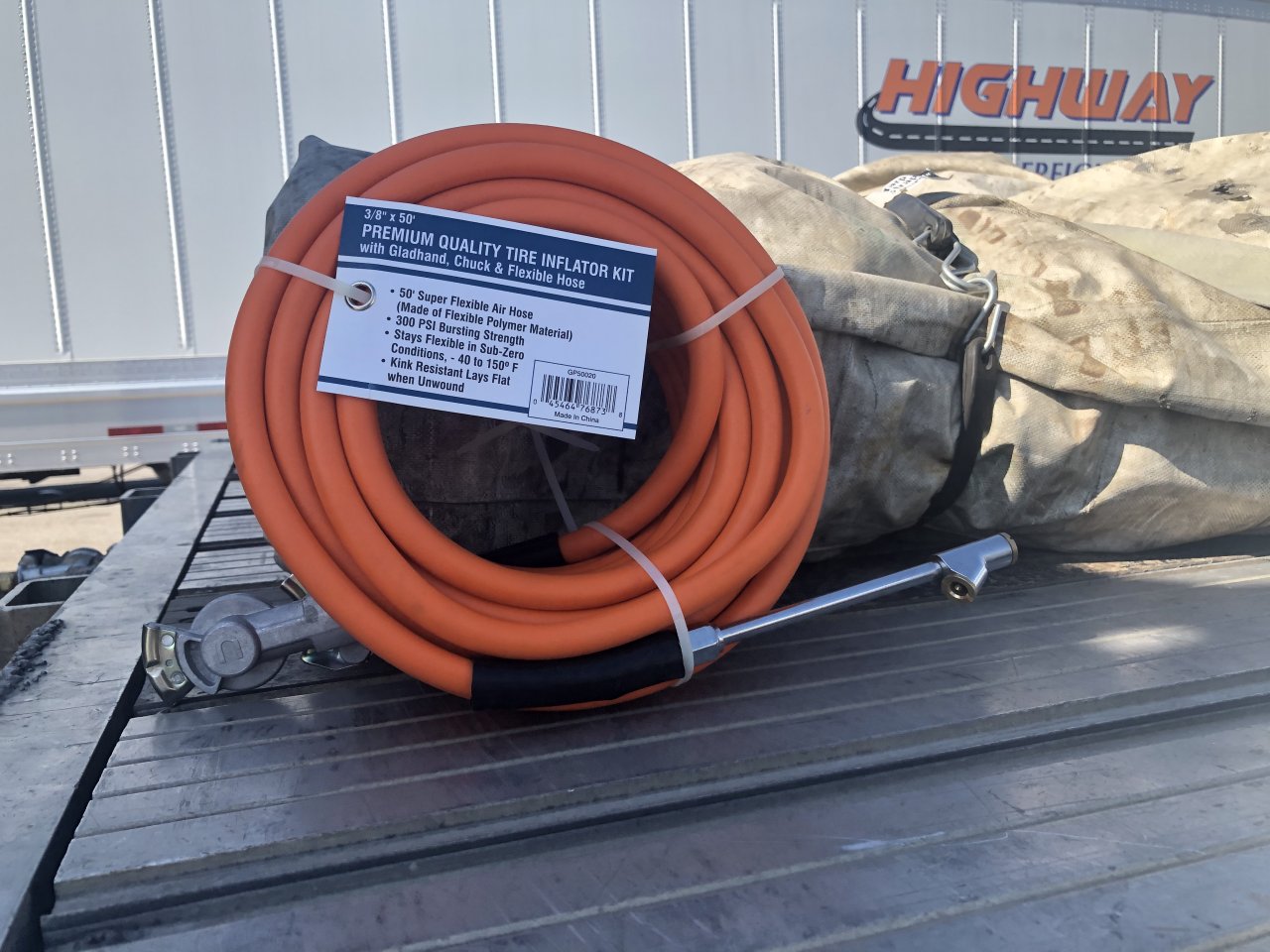

    Well I got it off of there, now I’m just having trouble airing it up. I connected the glad hand to the red glad hand and it’s not blowing out any air; I pushed in the red trailer air supply knob and after a bit it pops out saying “Trans Air Pressure Low Warning” on the dash; little help as to what I’m doing wrong? 5947398D-D50B-49A0-88F2-F14ADFDE25DF.jpeg

    Im just gonna say this. When yoh use that, remember to SET YOUR TRACTOR BRAKES. Because you have to release your trailer brakes for it to work.
    Yes, I carry a glad hand air hose, no I have never had the truck start to roll away.
    Edit: Brain fart. I fixed it

    Sure you didn't get it backwards there? Set the tractor brakes (pull out) and release the trailer brakes (push in). Since it runs off your glad hand air is (or should be) supplied only when trailer brakes are released.

    This is what I tried and it’s not working, I’ll give it another go though

    You connected to the red line on the truck and not on the trailer, right?
