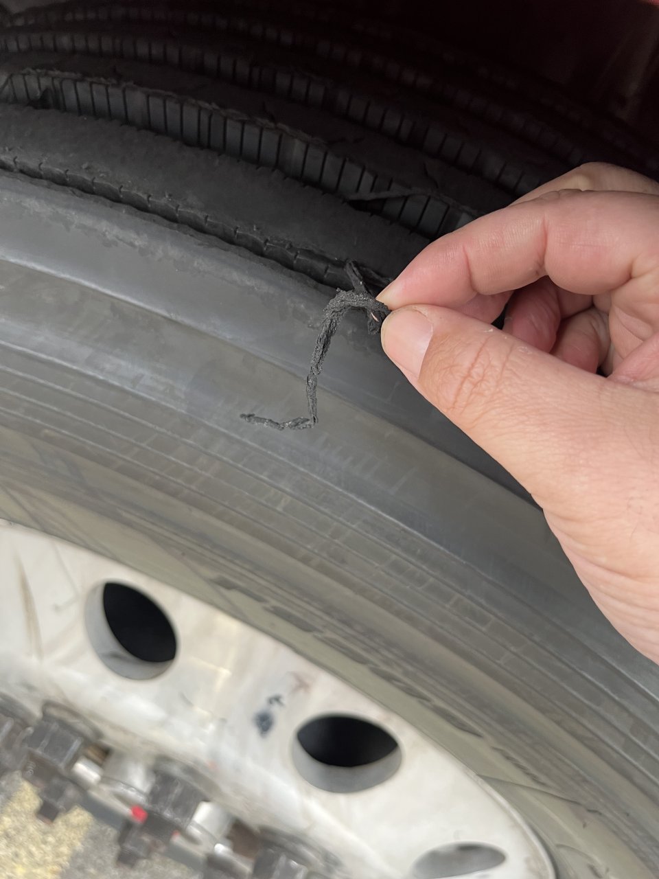

    Drove to volvo dealer 30 miles with new tires and its slicing them like grated parmesan
    Hopefully this #### will end

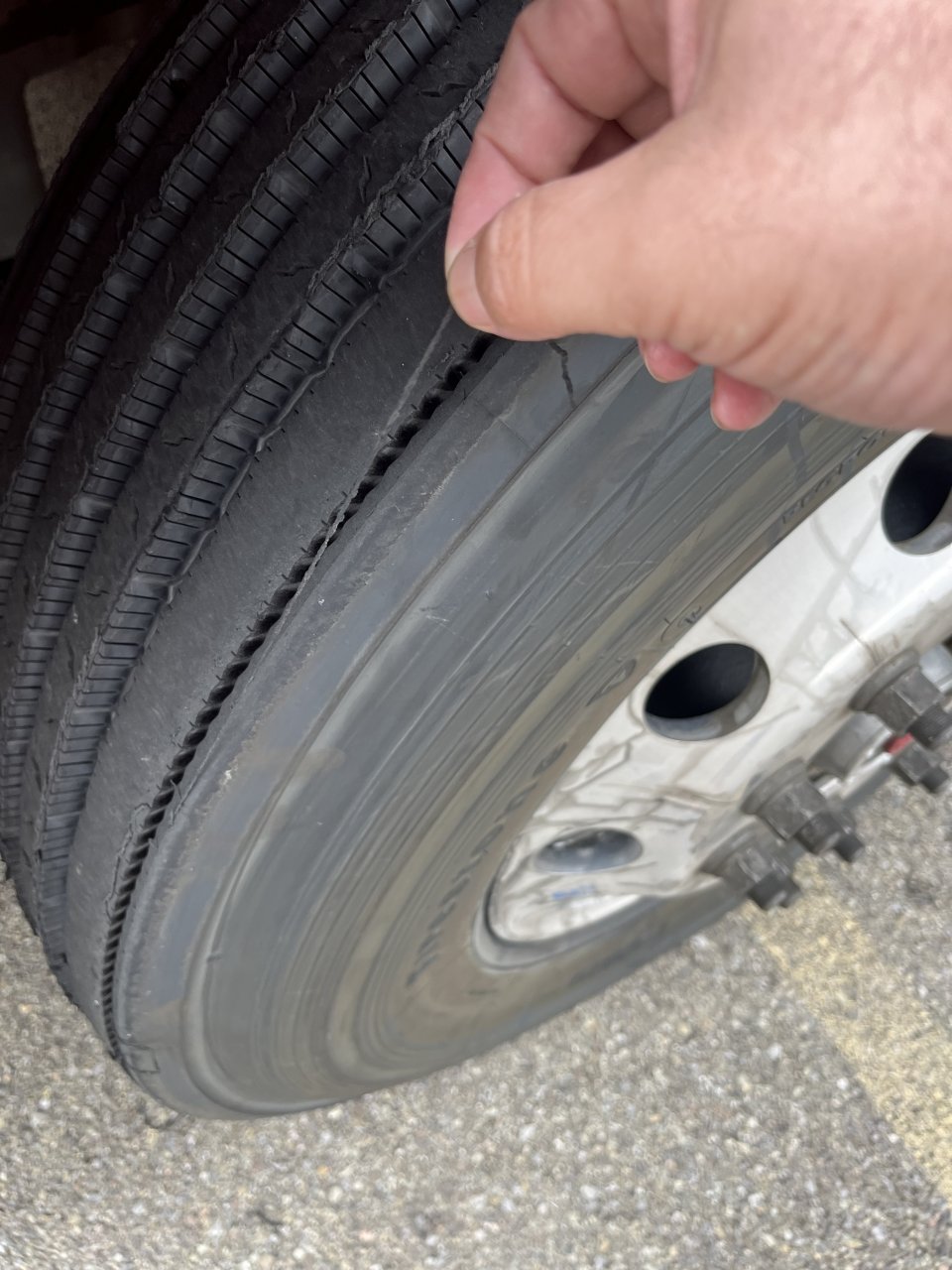

    So did that happen in 500 mi or 30? either way that’s a terrible job. I would think they would be so far out of whack you could see it but can’t really pick anything up in the picture. Could you smell burnt/hot rubber while you were driving

    This last pic is taken this morning,its a brand new set i put at ta 30 miles away

    No i didnt smell that but it rumbles a lot like bad used tires

    I’ve seen bent tie rods create the same problem….
