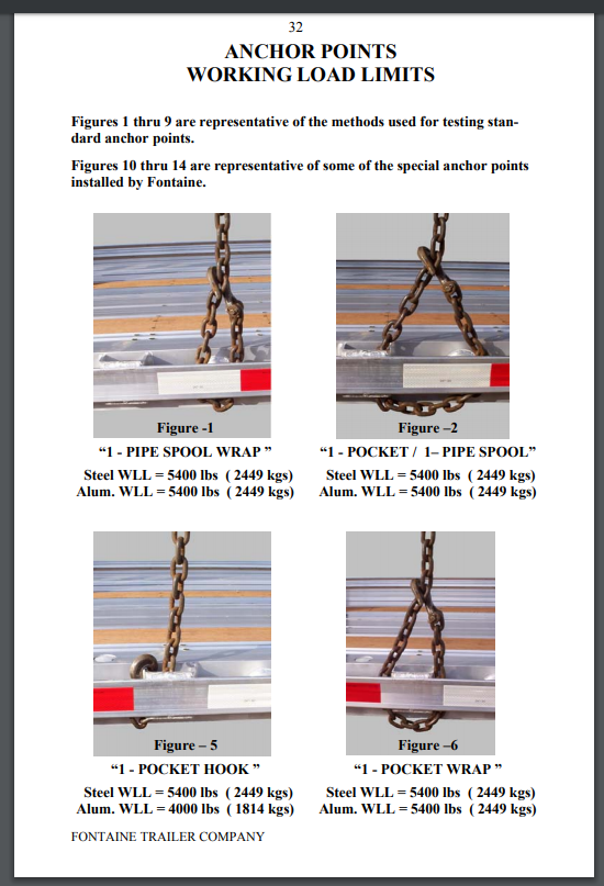

    You guys secure coils with chains to the rub rail? Do your trailers have the chain pockets? The chain pockets have a WLL of 5,400.

    Yes we secure to the rub rail. We loop around the spools. We are allowed to loop around the stake pockets if necessary. Our Utility brand trailers do not visibly say the WWL of the rub rail is, so we are expected to just do as told and consider all parts of the rub rail 4,000 lbs capacity.

    Every manufacturer may be different but here's what fontaine says the WLL of their rub rails is. The only hook method less than 5400lbs. is when hooking the hook onto an aluminum stake pocket(figure 5)and it is rated at 4000lbs when used that way.
