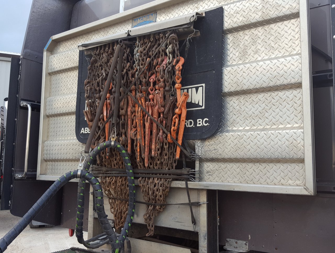

    Here is a 12 chain rack (the trough at the bottom *should* only hold 12x, 16' 5/16" chains) with 16 chains and binders.
    I'd like to say I came up with all this by myself, but I didn't. From hanging the binders from the chains, to hanging extra chains from all the binders, I learned from other drivers who offered tips. I go nuts with bungees to keep the chains from bouncing around and giving me a headache.
