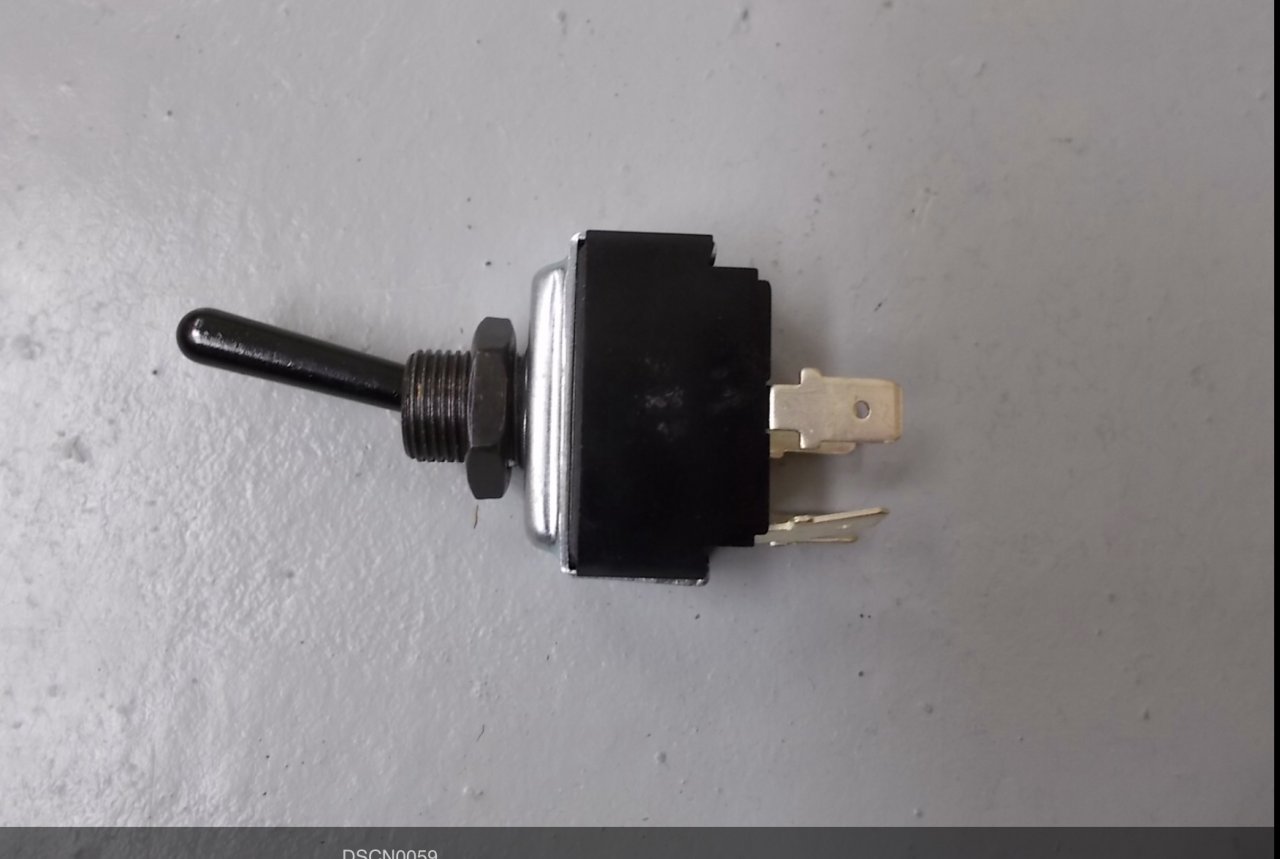

    Heres a pic of the back of the switch
  4. 062
    062 Road Train Member
    6,350
    34,015
    Oct 20, 2013
    8A826902-113E-455B-9A30-99FFDABBD673.jpeg Does it look like this?

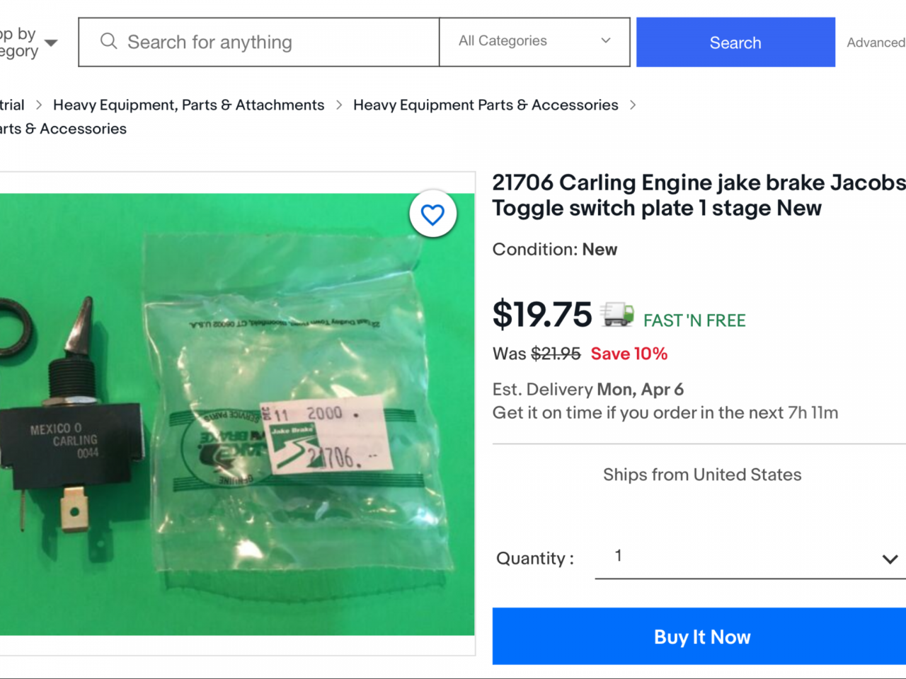

    You may be able to use a generic switch, but the exact switches on eBay are cheap. Just google what you need with eBay and you will find it. 362CD298-5E67-468D-A840-51930A0CD52F.png

    That looks like it lol ive been trying to look on google with no luck
  11. Banker
    Banker Road Train Member
    4,602
    15,400
    Aug 19, 2012
    Easy fix. eBay usually has it to you in a couple days.
