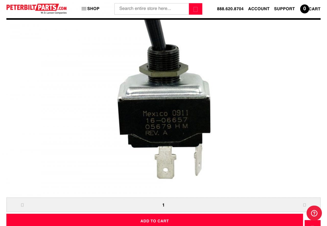

    Yea im about to look on there. Ive been looking on google but everything was 3 ormore terminal blades.

    Not for things like this. That switch I posted a pic of is $50 from peterbilt, danshop it’s $20.

    That switch I posted a pic of most likely will work, but you’ll have to check continuity and cut off or tape the two unused legs.

    D4F0B3D6-4C83-4C34-9562-58DF7568C085.jpeg It chopped the bottom off the switch, but it shows to be two legged.

    I had the same problem on my W900. There were a couple unused switches in my dash, so I moved it. Dealership wants $65.00 for an on/off, single pole switch. KWs are ground switched. The dash is grounded, the switch completes the ground. Single pole.

    The on/off can be replaced with a standard switch but you might need to move the wires in the connector to get them on the right switch terminal
    The connector is a Delphi 56 series (formerly Packard). Some of those connectors are molded with blank spots so they can't be plugged into the wrong switch. If need be the body can be replaced with a 6F
    Delphi 12052978 56 Series 6 Way Female Connector 5 Pack Delphi 12052978 56 Series 6 Way Female Connector, theelectricaldepot.com, electrical connectors & more [D56-12052978] - $5.47 : TheElectricalDepot.com!, Electrical Connectors and Much More!
    ETA- I went back and looked at the picture closer. Looks like there are no blank spots on the connector and the switch is a standard configuration. If you get a DPST switch the unused terminals will just sit in the connector, no need to cut them off
