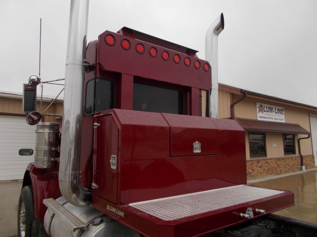

    I've seen at least one Knaack type, and a couple like it with varying sizes of boxes. @beastr123 shows one way. I was always under the impression that the ones I saw were bolted to the frame with pads between. mind you, those Knaack's are heavy duty and heavy, and almost as expensive as a 3 door vault headache rack. For example, the one I remember looked like this one:
    It costs $2,150.00 and weighs 400 lbs. and needs a lift to put it on and off, same as a headache rack and you'll have to fabricate the needed securement, but this vault:
    costs $2,931.00, weights 300 lbs. and has premade securement. There are cheaper models, and different configurations for this, but IMHO, it's much more functional for the flatbed point of view...and it can be added to and accessorized as you're able or need. Storage area for each is 31 cu ft for the Knaack, and 41.71 cu. ft for the Vault cab rack.
    Not to dissuade you if you're intent on the deed, but just raising the issues to consider. The box will be 100 lbs heavier, and 10.71 cu. ft. smaller, less efficient for flatbed work, and need custom fabrication of mounts to secure it, unless you can make existing mounts work without modification. Yes, the vault rack is a bit more, about $800.00, but IMHO, worth it.

    That’s like what I had on my last truck. They are good for hanging chains in the outside boxes, but seemed like a lot of wasted vertical space. I want to haul a small gas generator and some hand tools in case of breakdowns like I had on the attempted drive back from Mississippi with my new truck.

    Well, nothing keeping you from having a side box, unless there's no room. The vertical area could be increased by hanging things on the doors on the inside, like tool mounts for those tools you mention, the generator also in a side box....but what ever floats your boat. :)
    :banghead:
    In hindsight, you might want to opt for one of those drom boxes. :)
    Maybe like this one? It definitely will be more expensive than the vault box and the side boxes. :)
