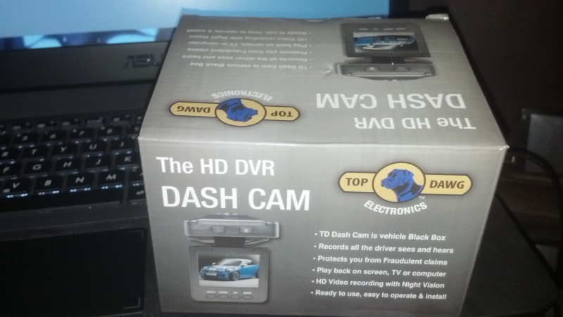

When I got the box, I knew straight away this might be trouble- the box was incredibly light. I'm not saying that weight is necessarily indicative of quality but I would be lying if I said otherwise in this case.
"AVI Format, 848x480 view size @ 15 FPS. Display is a colorful 2.4 inch TFT screen that rotates 270 degrees to suit driver viewing preferences."

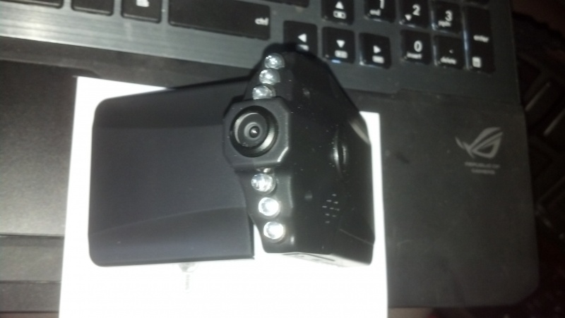

- The Camera itself is fairly small, being only 4-5 inches long and 2-3 wide while being 1-2 inches thick.
The low-wattage Infared LED's attached to the front create more problems then they solve. They have a tendency to create glare off your windshield interior, and when the camera notices this; it shuts them off. However it will turn them back on a few seconds later, only to shut them off again. This process will continue until daylight breaks.
- While it may appear sturdy and rugged, the camera is extremely light and frankly; flimsy. You could very easily brake any number of things off the unit thereby completely ruining it.
While working with the buttons to select menu and mode options, I have almost accidentally broken the screen off several times. Not a very ergonomic design for $100.
- Here the camera can be seen with it's screw in mount and the screen closed (note; the camera will not function without the screen open, and folded down. It will shut down otherwise.) I will post another picture of the screw on mount later.

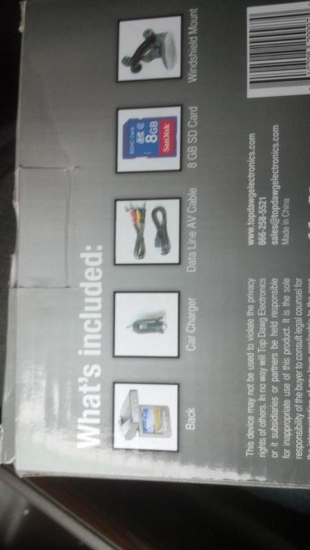

- (cant seem to rotate this picture in the thread box, not re-uploading) here is a diagram of what's included in the box.
