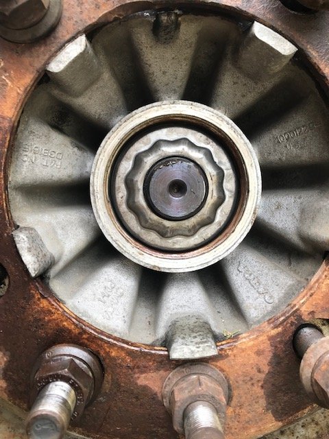

    Looking for Torque for Nut on 2007 Volvo Unitized Hub Assembly. Hub Assembly is a Volvo/Conmet 21024245/10020057 hub. I called Conmet and they told me to call Volvo. Called Volvo and they told me to contact Conmet. I can't find anything on this particular set up online other than a video showing someone doing it but not showing how they torqued it. (The picture is one on a junk truck and the shield is in place) Hub.jpg

    It is a unitized hub that appears to be Volvo only. I had to use a used one (which was on a wrecked truck that we had bought) that actually turned out to be new hub, new shoes, and new drum. The dealer did not have one in stock. Who ever put the one on the wrecked truck had chiseled the nut on I guess because they didn't have the right size socket. I had the right socket for the main nut but had to go buy a socket to remove the dust cover.
