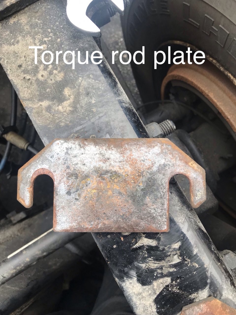

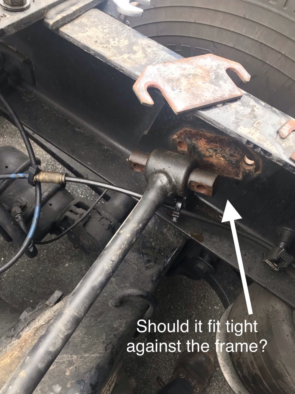

    When installing a torque rod, how tight should it be touching the truck frame (without the bolts on). My torque rods (above each drive axle) have thin plates. Should I add enough (or replace) the plates so the torque rod fits tightly against the frame? One of my torque rods doesn’t fit as tight as the other (without the bolts on).
    2014 Freightliner Cascadia DD15.

    Put it back the way it was before. The frame shims are to be added or taken away for alignment purposes to center the axle to the frame for proper tracking. Make sure the new arm measure the same as the old ones and the spacers/ washers are in the same position on the axle bracket.

    So what happens when my front axle torque rod is much tighter to the frame than the rear axle torque rod? I suspect someone messed around with the frame shims as they are of different size thickness on both of my rods.

    Your suspicions may be correct. As a rough guide drive the truck a bit to let everything settle and measure the gaps from inside dual to frame to see if the gaps are equal at all 4 drives.
    Either way a 3 axle should be completed to ensure everything is in line.
    The other thing that works is a straight edge on the outside of duals to see if all four sidewalls touch.

    If all was well beforehand, it should go back same way. What’s happened is the axle shifted when you took old one off.Once new one is installed, everything should be lined up exactly as before. It will be doing its job. If you add shims now, it will definitely be off center. Your lucky you don’t need a jack between tire and frame to get bolts to reach. I broke one once. rear axle shifted a good 6” or more. Took a lot of persuading to get it back in line. Dealers Shop Service adviser, wanted to drop the whole axle, new u bolts etc. Luckily the young mechanic, did what I suggested, using a couple jacks. Before the adviser knew. Saved Me hundreds.

    How do I find out which size of torque rod plates (or frame shims) originally came with my truck? I asked the parts guy at the dealer this question, but he didn’t know. He did give me three different thicknesses that they carry:
    1.5, 3.0, and 4.4 mm
    Both of my torque rods have two plates each, but the thickness sizes are not the same.

    I don't think a dealer could tell you which size it came with, when built they use what ever it takes to line it up, it is normal to not have the same size shims. If it was lined up good before, then just put it back like you found it. If you don't remember how they came out, it would be best to just put it back together and get a 3 axle alignment done.

    Connect it how it was. Measure distance between wheel rim and frame on all four wheels. Adjust if needed with shims. upload_2019-9-8_21-1-1.png
