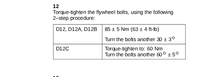

    Does anyone know the flywheel bolt torque specs for a 06 Volvo Vnl with a D12 engine. I'm replacing a clutch and don't want to over tighten the bolts.
