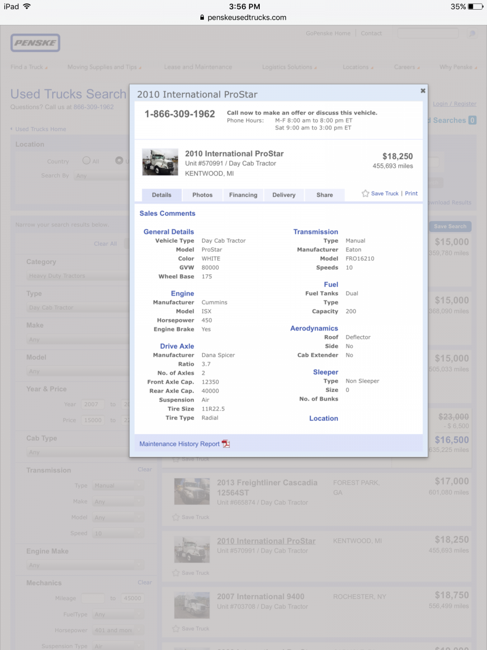

  7. Derricks
    Derricks Bobtail Member
    12
    Aug 26, 2017
  8. shogun
    shogun Road Train Member
    6,075
    72,164
    Jan 23, 2009
    Doing a regen
    That truck pictured isn't bad. I would remove the air dam, and do some 'adjusting' to the egr valve, cooler and dpf system if it was me. Then again, I would try to avoid the emissions stuff altogether. That 99 Mack or T800 listed in the above threads would serve you well.
    Dump trucking is rough on equipment, and you probably won't get great fuel mileage. So look for a daycab, no air faring, as little plastic fairing as possible. This can be a kenworth, Mack, international, peterbilt, Volvo etc. just go to truck paper and do a detailed search using those parameters.
