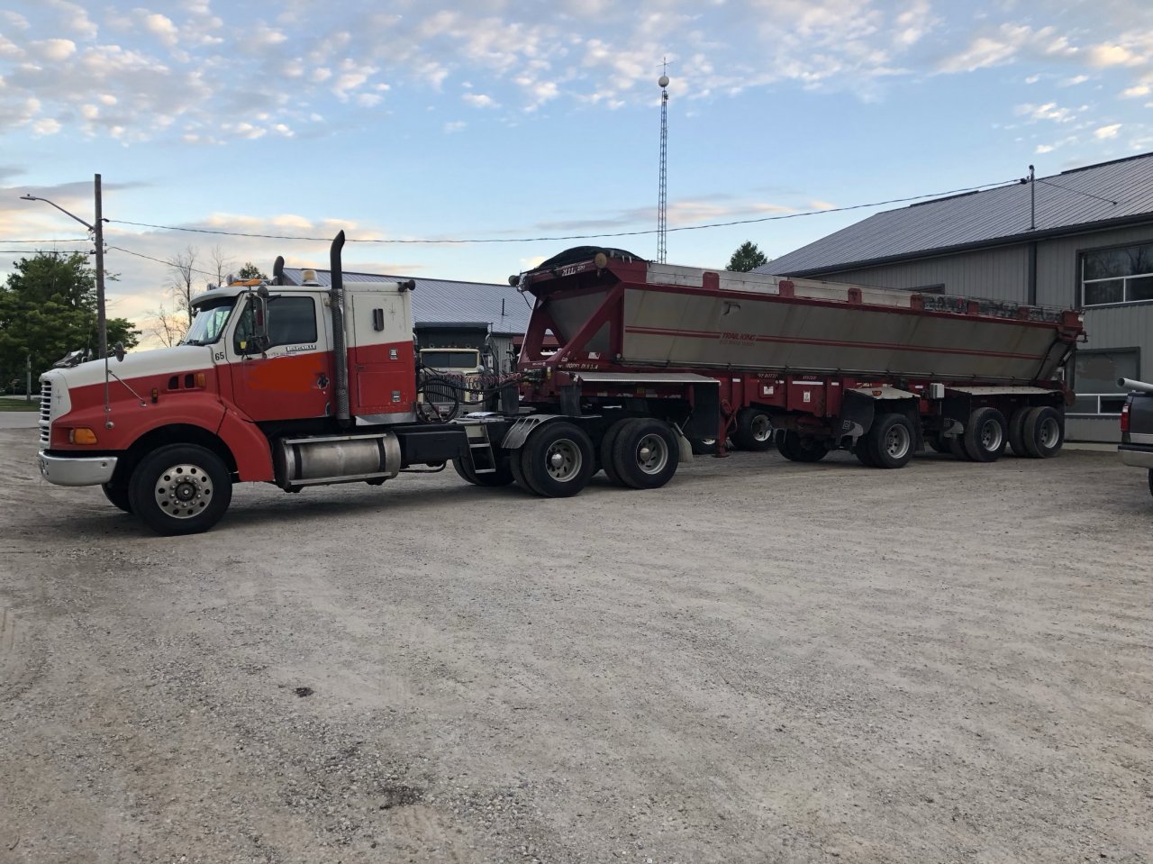

    Hello all.
    About a year ago, the company I work for purchased a Trail King live bottom tri axle trailer.
    This is a 2007 model
    It was a repossession and not too bad shape. It was in a jack knife at one point which damaged the landing gear and punched a hole in the skin of the outer wall.
    I replaced all the bent metal for the landing gear and straightened it out. Works good now.
    I have a few questions about those trailers as this is our first one to use.
    For the most part, we have figured out how to use it.
    We have to always walk back and run the manual button controls for lift axle, tail gate locks and tail gate.
    Do these trailers come factory with a control to operate the tailgate, lock and electric tarp?
    There is a secondary 7 pin plug which I’ve tested it with power and it works at activating the tailgate, the locks.
    There is also a 2 prong plug for the electric tarp.
    When running the belt, do we let the heap get large and pushed back under the weight of the moving load until near empty or we keep creeping ahead when the pile gets up to the belt?
    Some guys told me that pushing the pile off “burns the belt” but I’ve seen others doing that too.
    I’m also trying to figure out how to operate the chain Oiler system. I’ve got the oil to flow but makes a mess on ground when running.
    We really like this trailer as it’s really safe compared to end dump trailers we used to have.
    We’ve had several trucks/trailers flopped on their sides multiple times (before I worked there) and like many companies, the end dumps are at the point of not being welcome to sites anymore.
    How does the belt get replaced on these trailers?
    Trout river has videos of their trailer operations and how to change the belt but Trail King has limited info or videos.
    I look forward to learning more about these trailers.

    Is the belt a solid belt attached to drive chains or flaps attached to drive chains, or just a rubber belt that runs on rollers???

    Cattleman 84:
    Hello, it’s a solid belt attached to chains

    Never used a trail king but used a Flowboy a lot at a job I had for 8 years we always pulled up when the pile got to the belt just so it didn’t get the product all over the back of the trailer. Not going to “burn” that belt it’s attached to a chain but you can break it when it gets worn out and it’s not fun to replace. We hauled sand we used to load those poor trailers with 30 tons
    Wire up some switches for the tailgate if it has a plug

    Idahojoel; I’ve never heard of a flowboy. I’ll have to look them up.
    The trailer does have 2 plugs besides the standard 7 pin for lights etc.
    Just have to wire up switches and wiring for 4 tractors to use this trailer as everyone in the company drives the truck they like.
