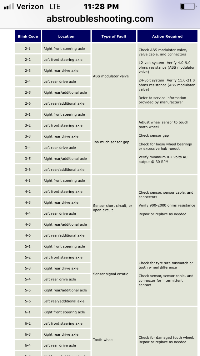

    854334B9-E46A-4FE3-A885-AA3F11D1D0C5.png Check with key on. Blue has constant power. abstroubleshooting.com has Wabco codes. Although mine had been spliced together by Penske, before I bought it. It’s against DOT rules to splice abs wires, from what I’ve read.
