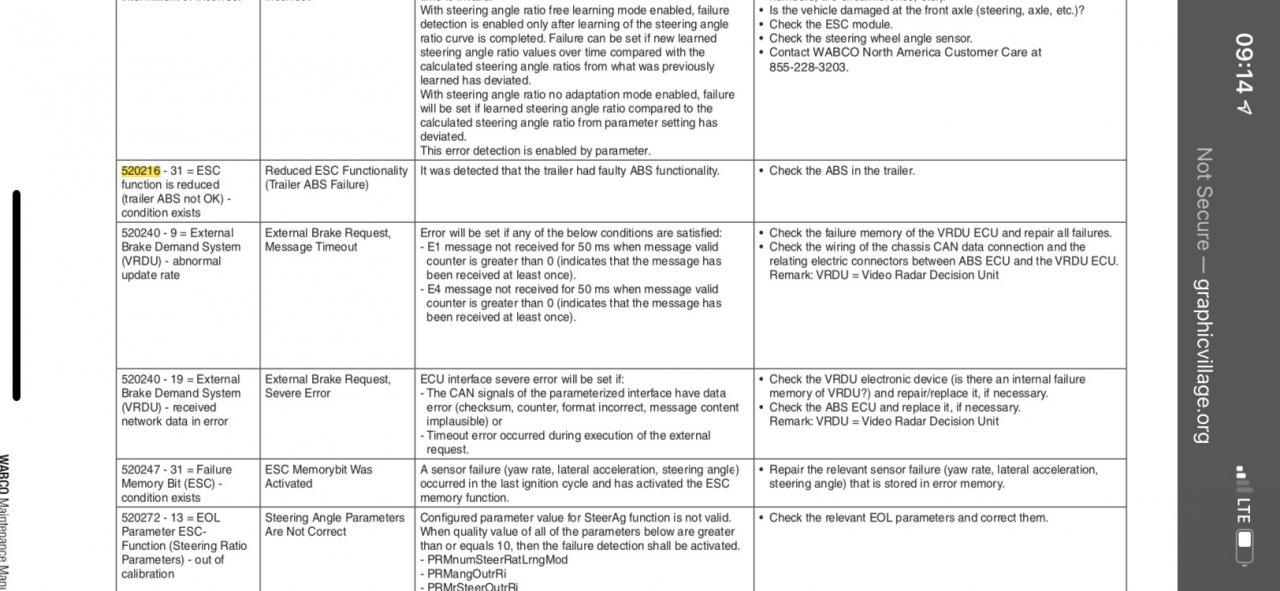

    Picked up this trailer this morning and the ABS light came on and won't go off. Any help would be greatly appreciated.
    The code that is popping up is ABS 520216 31
    My husband is the one driving. I took the picture from the passenger seat.

    If you just picked up the trailer, the problem is with the ABS sensor on the trailer. If you're going to drop the trailer someplace, the problem will go away then. If you plan on having the trailer for a while get the sensors looked at.

    Probably the trailer has a bad sensor. Unplug the trailer and see if it goes away.

    Yes, I know there is a problem with my ABS. I was asking if anyone might know what that SPECIFIC code was.

    It means your trailer abs has a fault.
    http://graphicvillage.org/meritor/MM1719.pdf

    ABS sensor(s) could’ve been knocked loose(it does happen) or there’s another underlying problem with that system. Either way it needs to be looked at. DO NOT be one of those drivers that unplug the ABS light on the trailer-that’s asking for trouble(it’s installed for a reason). If left unchecked you could possibly have a thermo event (brake/trailer fire). Who manufactured the trailer(Utility,Great Dane,Hyundai,CIMC,etc.)?
