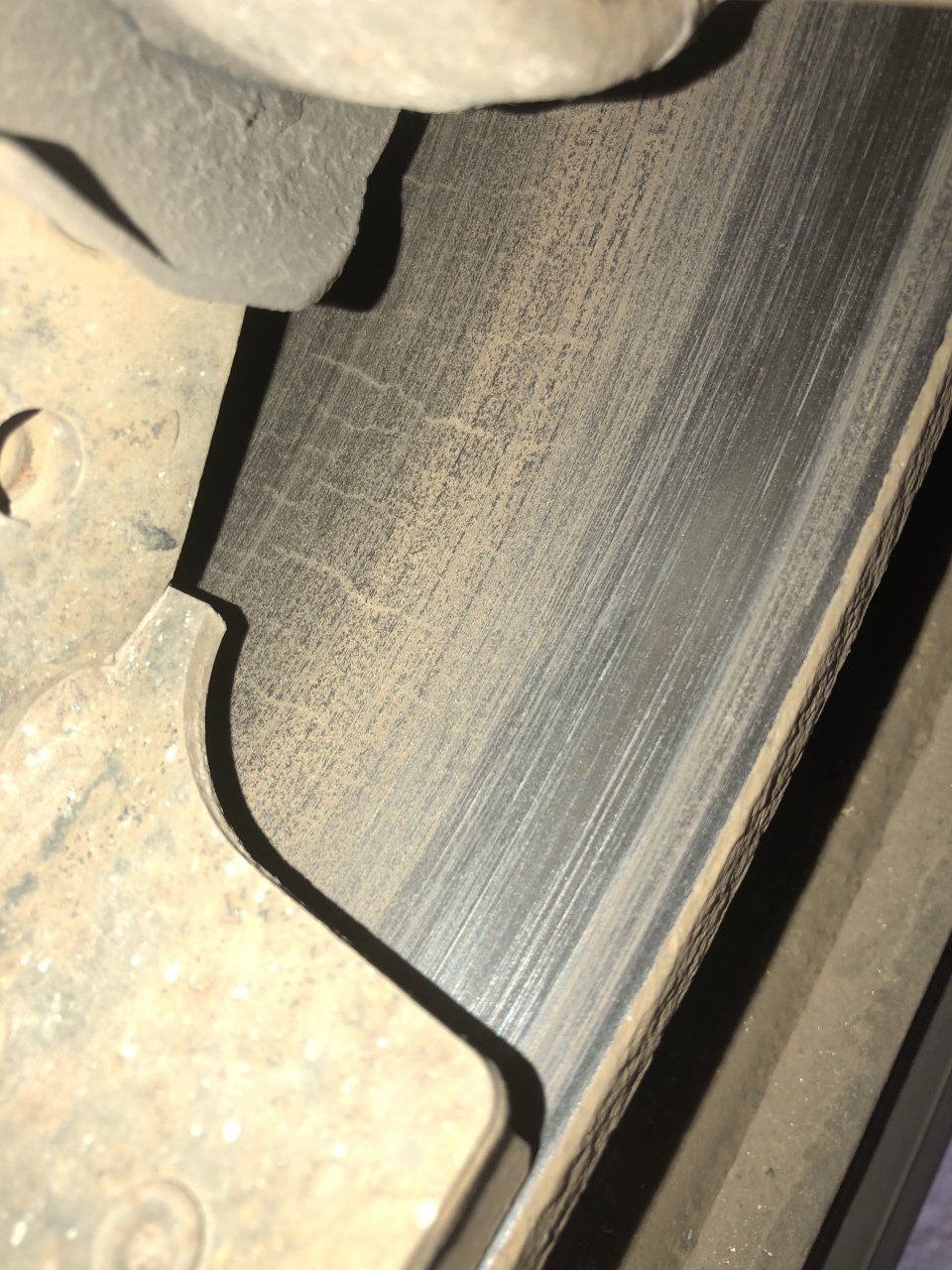

    Picked up a trailer a day ago and ever since I picked it up it felt sorta odd. I can still stop safely couple that with the fact that I use the engine brakes for speed control only ever use regular brakes for complete or quick stops. Anywho I picked up this trailer and I thought at first it might be the weight or the trailer might have sat for awhile and needed to shake abit or rust off the brakes but honestly feels like the previous driver might have glazed the brakes. I’ve never pulled a trailer with glazed brakes so I’m not sure to call it in yet. The brake pads have tons of life in them but when I took a look at the lining it looked abit odd. Maybe some more experienced trucker can tell me if the lining looks odd to you. Each photo is a quick snap I took on one of each forward side even the rear brakes look like this.

    How's the brake adjustment?
    Glad hand seal not folded up and restricting air flow down the service line?
    Dave_in_AZ and Ffx95 Thank this.

    Those drums either need ground down or replaced. Those are heat cracks from someone riding the brakes. If you get DOTed thy will right it up, don't think thy will put out of service but will note it on an inspection.

    Glad seals are good. Slacks still within specs.

    Stress cracks are normal

    That much heat going into the trailer brakes could mean someone was using the trolly all the way down a steep grade.
    The first photo shows it more clearly.

    OP talks about brakes but posts pics of drums.
    Adjust all your brakes. You can say they're within specs but I'm betting you've got gaps between the shoes and drums. Close those gaps
    Nicely adjusted brakes make a world of difference.
    And those drums aren't glazed. That's normal wear and tear. They get that way when it's time to replace.

    Shoes not touching drum evenly. Look at the edges, all clean and no dust on them. Center looks untouched and dusty. Trailer probably not greased often, cams get loose and sometimes even seized.
    Cracks are "normal", only time it's considered "bad" is when it's from one end to the other. DOT won't say a thing... In my opinion they stretched drum lifetime a bit too much. May be the 3rd set of pads they are seeing. They are used evenly but they look very carved when looking at the outer lip of the drum. Seems like they have the right lining/drum combo for it's application, simply should have been changed last time lining was done.
    What get DOT attention is when drums aren't evenly used, and you can see multiple lines of depth on drum. I have heard of resurfacing a drum but never done it, not worth it in my opinion. Drums are not that pricy. Drum should be expected to last 2 linings.

    Drums don't last 2 linings.
    My first lining gets close to the rivets and the brakes cam over.
