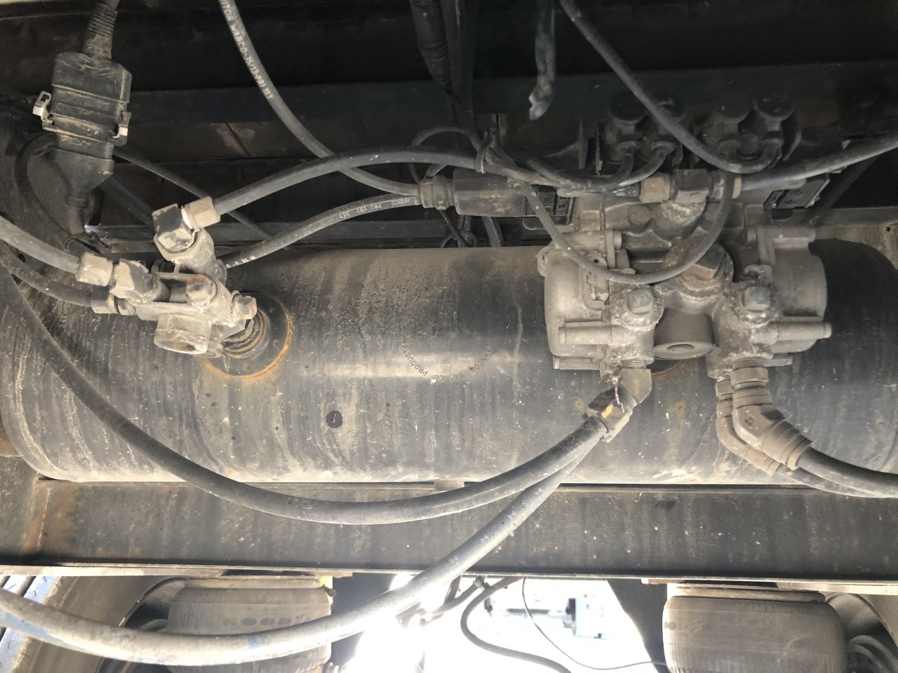

    5739378E-4D54-4243-B970-A07484ECFA04.jpeg 70B7D06B-EB4A-4445-83DF-C2950CD2176F.jpeg
    Mr @GrapeApe is it possible the check valve can fail in a way that can cause the spring brakes to not release?

    Not that I have ever run into, but I can't say that it's impossible, just unlikely. That looks to be a Sealco 110500 valve. That has what they call spring brake priority, meaning that it won't fill the tanks at all until the chambers have enough pressure to release the spring brakes.
    If your spring brakes are not releasing, it's a fairly simple diagnosis. The spring brake release valve is the only thing between the red supply line and the spring side of the chambers. Check air at each point until you find where it's not coming through. It could be a blockage inside the valve.
