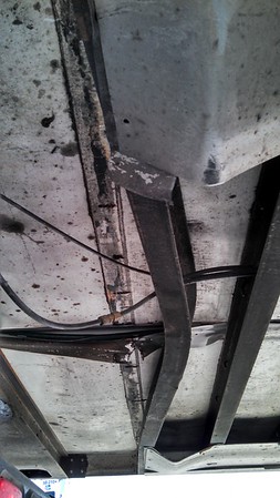

    Of your most recent photos there is no doubt the first one is of a aluminum crossmember that was poorly repaired.
    The second one you cannot really see the metal beyond the dirt and/or insulation but the thick cross section for a crossmember is a clue.

    Holy Moly! That reminds me of this one that I moved too.... to another trailer too. Lol
    I understand how the first cross member got damaged. But behind that 1 there were two good crossmembers and then there was the other two that I don't understand how that happened?

    Third pic sure looks like a bad "drop" on a train fifth wheel.
    But one and two? I don't see any scrapes on the rail to give evidence to what happened. Most likely due to many miles put on the trailer after the damage.
