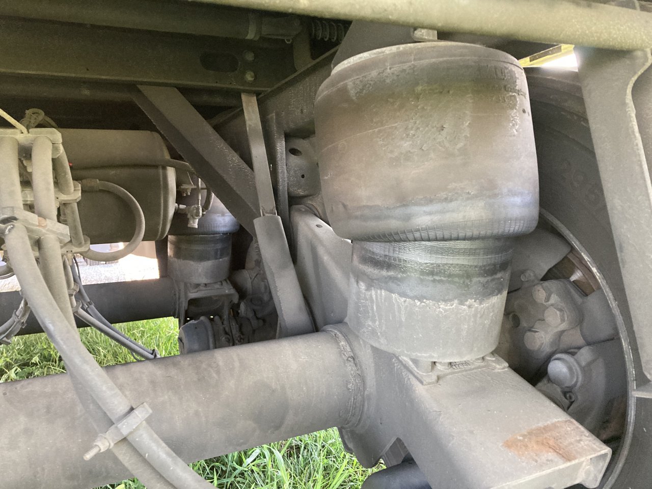

Trailer height control valve

    Looks like a Hendrickson Ultraa-k suspension. Ride height is 16 inches measured from the bottom of the frame rail, (top of air bag) to the center of the axle tube.

    Being its a company trailer let them deal with it. It is possible, that the bags will tear at the bottom and you will have a major air leak.

    When I had the same problem, the trailer brakes would lock up very easy, when empty. Heads up.

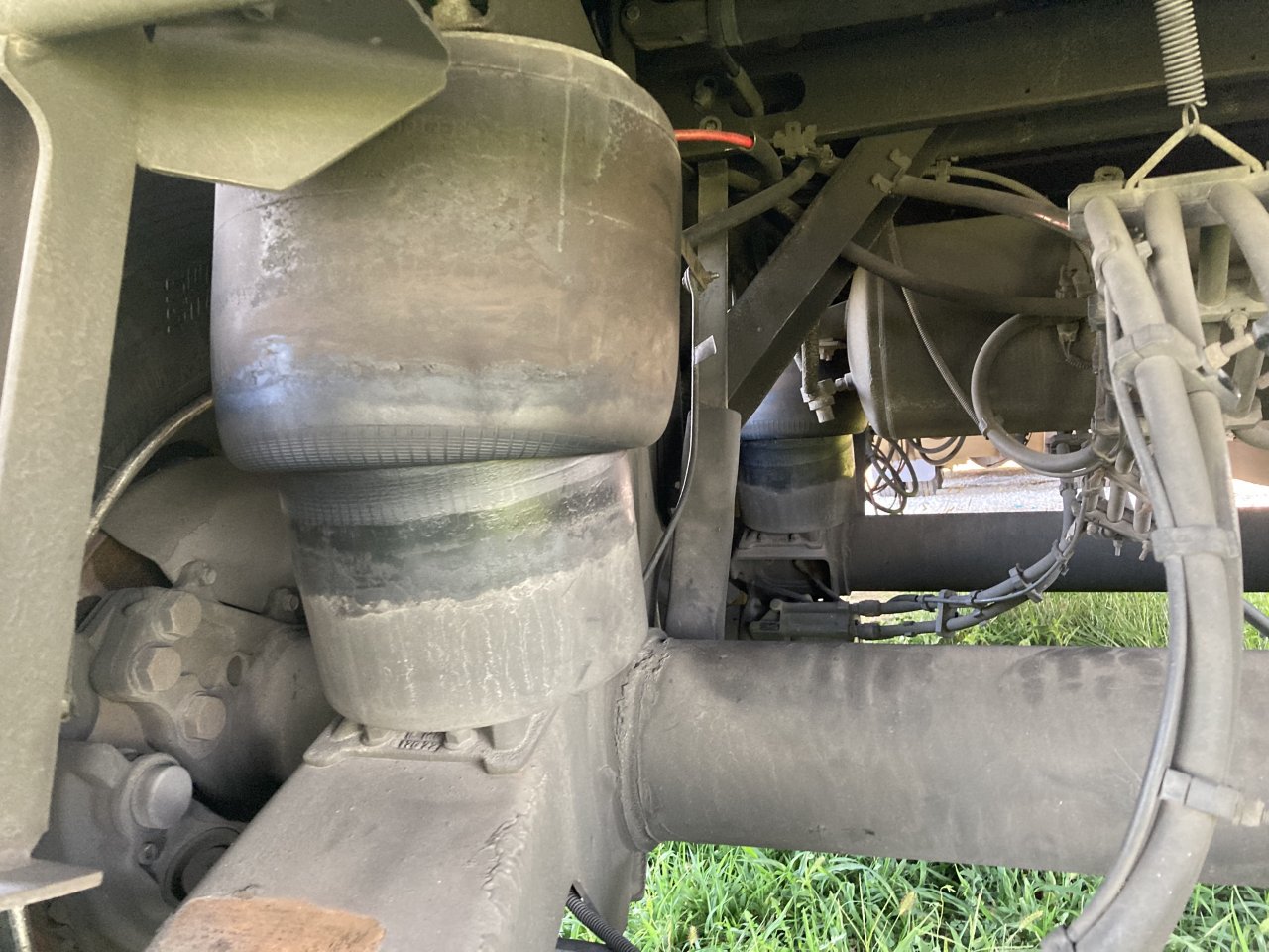

    The air valve dosent appear to be mounted to anything. Am I seeing that wrong?

    You and I both.
