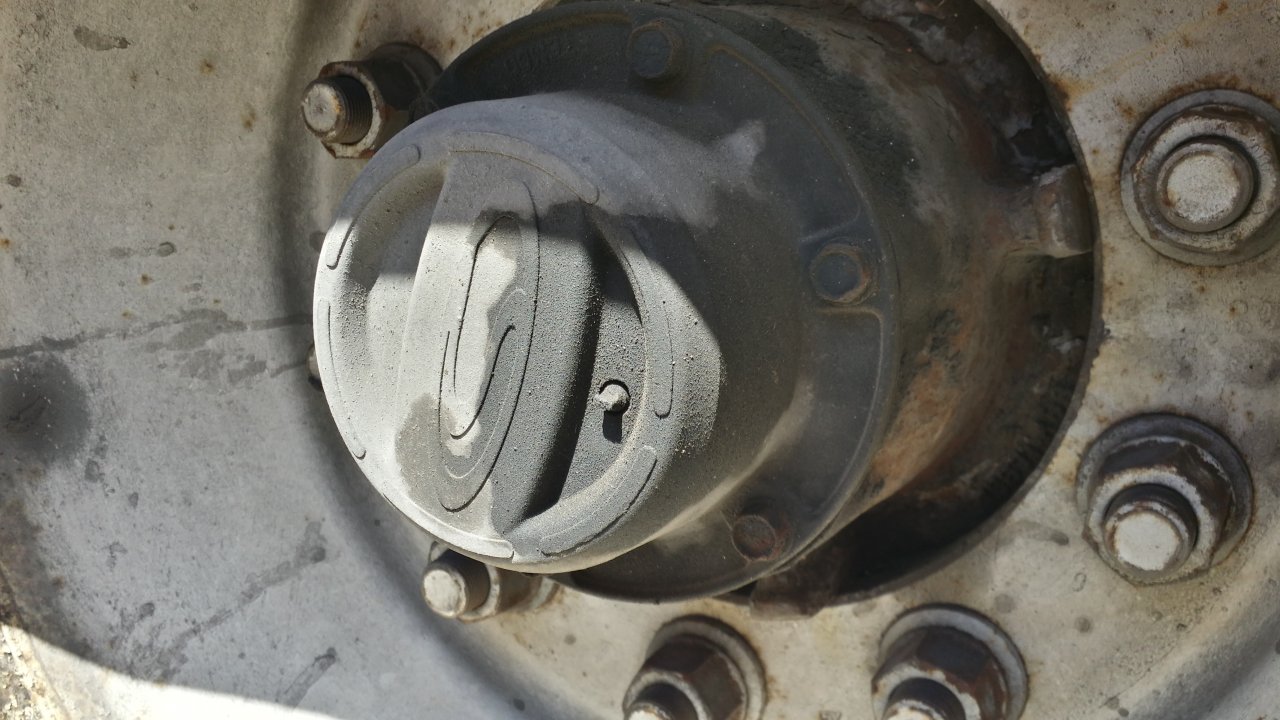

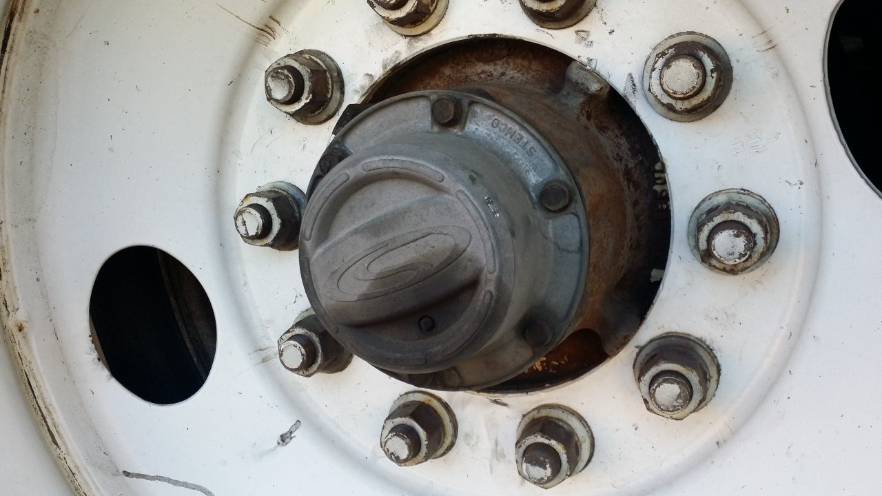

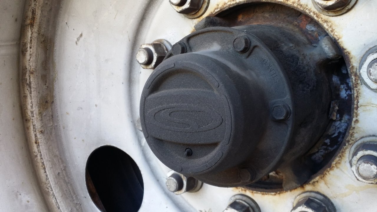

    Hello, looking for just a little guidance on topping off the oil in the hubs. I bought this trailer approximately 60k miles ago, and even thought i get the trailer greased up often, I never did anything with the hubs. I started noticing oil buildup around the them and i was wondering what can i do about it myself. All four hubs have oil deposit, some just around the plug and the others around the seal and the plug. I'm looking to just top off the oil in these hubs for now, how would i go about doing that and what oil should i use. From the look of these pictures, is this something that needs to be addressed immediately? Thanks on any suggestions.

    this is grease packed hub. no oil inside.

    Looks like grease hubs. I wouldn't worry about it. When you start seeing grease all over the rims is when you need to worry.

    I've been away from trucks for a while and we would rarely see the grease style hubs so I'm not 100% sure. My best guess would be wheel bearing grease.

    forget about this grease. it's old. Grade 00 Semi-fluid grease is now approved standard for hubs. mobilith 007 or Delo SF..
