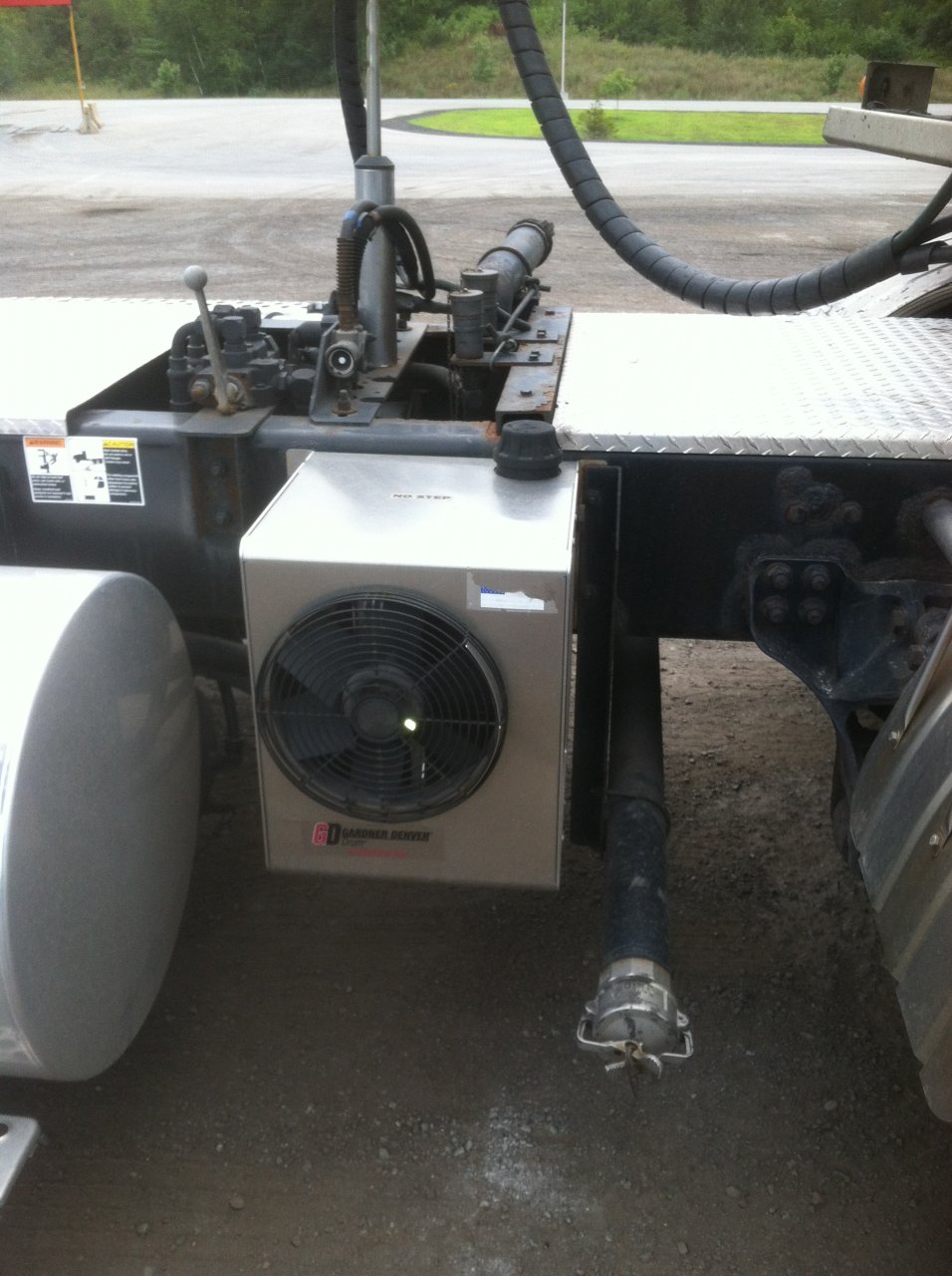

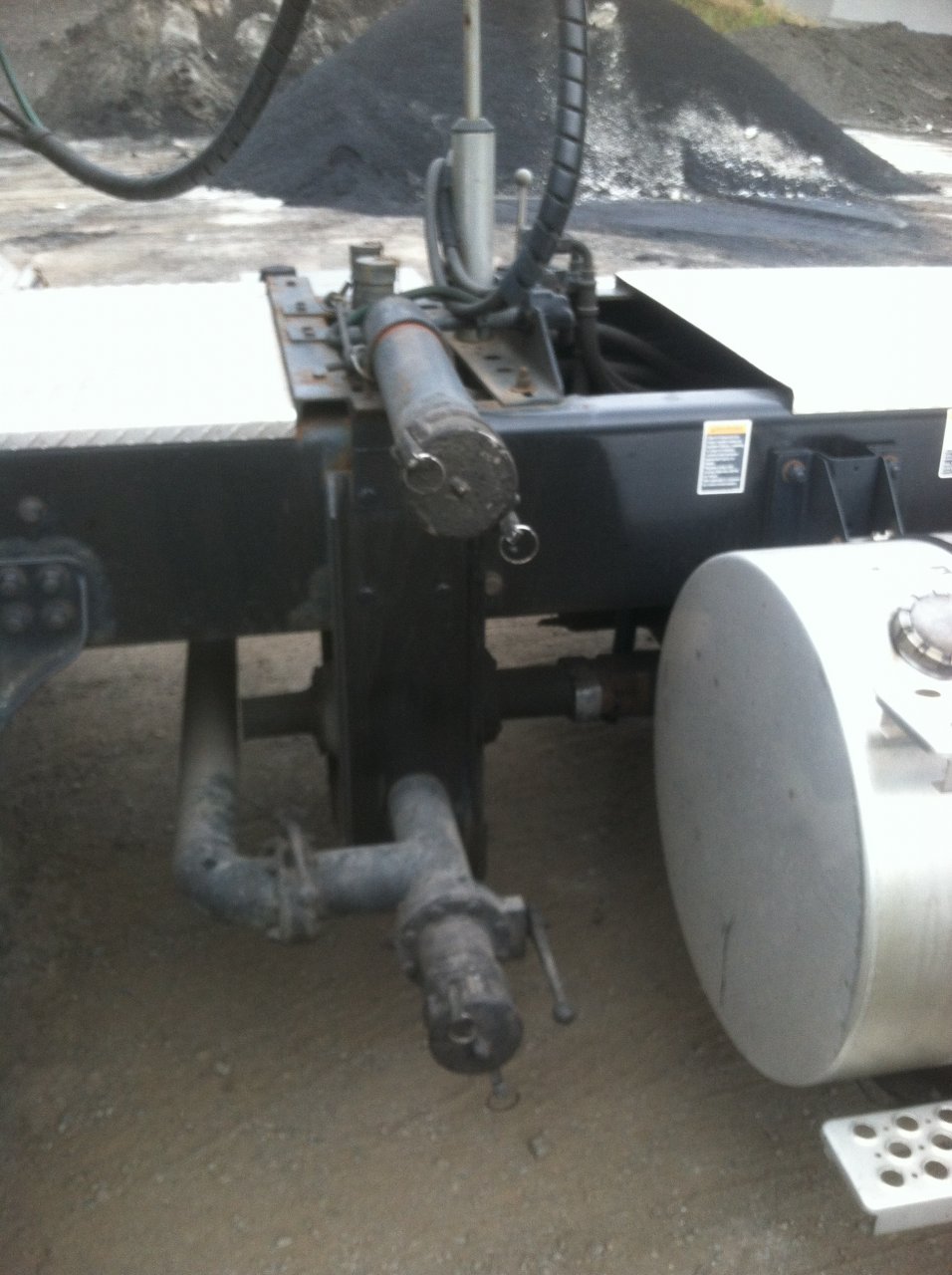

  7. Cat sdp
    Cat sdp . .
    21,318
    76,328
    Apr 8, 2012
    Orion's Belt
    Ya, liquid pump at least 2k and up ... drum hydro pack cooler 2700 and up. And so it goes . The higher the gpm you want to move the more money you'll spend .
    Hyd driven product pump is the best way to do it. Drive shafts suck...:)
    Jamesnuzzo1 Thanks this.
