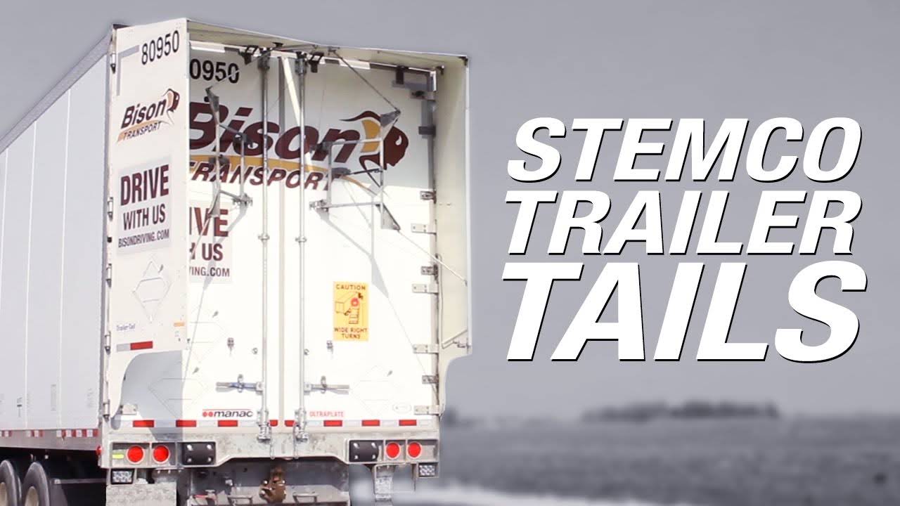

    Anyone know how the rare reverse lights mounted on the rear of some trailers (usually tankers & owner-op vans/reefers) are wired?
    Is it possible to somehow use a standard 7 pin on an ABS equipped truck/trailer, or do you need to have an auxiliary cord?
    Pics of a tanker & Bison transport trailer with reverse lights.

    Have you verified that those lights are indeed reverse lights?
    Seeing a lot of people using yellow brake lights lately. How they get away with it is beyond me. Seeing a lot of whites that are actually red leds. Although that don't appear to be the case with the flatbed.

    Those 2 pics are just stock Google pic footage to give examples so I cannot verify, but more than one Bison driver has confirmed they have reverse lights on newer trailers & the white LED lights appear to be either those or a white work light hanging below the outside brake lights.

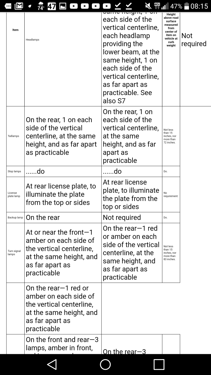

    Table 1 towards the bottom of Standard 108 says a trailer only needs 2 red brake & 2 red tail (marker) lamps minimum.
    Since you can combine the function of brake & tail into one unit, the tanker has the minimum required & chooses to use the allowable 2 minimum amber turn signals for that function.
    https://www.gpo.gov/fdsys/pkg/CFR-2004-title49-vol5/xml/CFR-2004-title49-vol5-sec571-108.xml
    Screenshot of table I am referring to.
    Understand what you mean about the clear lights that light up red or amber, I guess as long as they are the color required when lit its ok?

    Regardless, I think this tanker also serves to show the proper placement of turn signal vs stop/tail; evidentally the turn signals have a wider maximum allowable spacing (at 83in) then the tail lamps (at 72in)
    Table II of Standard 108, proper light placement for vehicles/trailers over 80in wide.
    Screenshot
    So turn signals should legally & logically be at the furthest extremities of the trailer width (within the allowable specs) which I don't always see; the previous Crete/Schaffer pics included.
