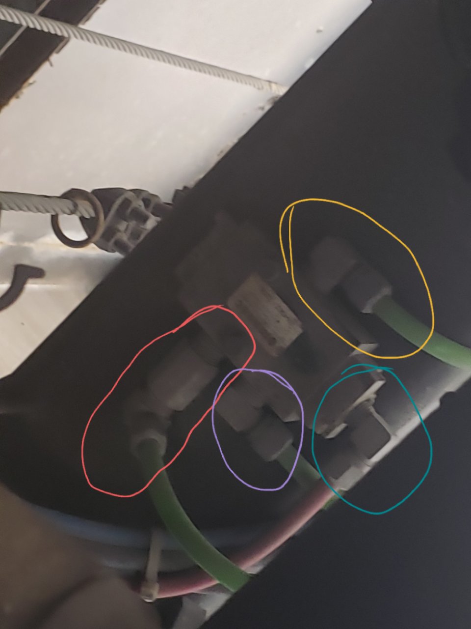

    Could that valve regulate the pressure coming out of the tank?

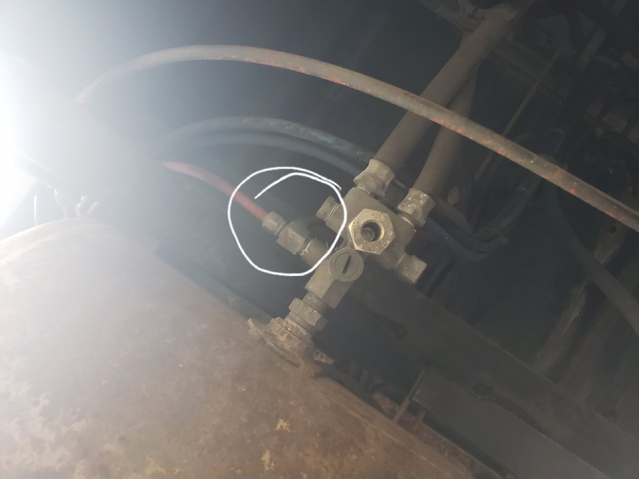

    The valve on the tank is a relay valve. If that goes bad you will have a long delay before your brakes will apply, or release to your trailer when you step on the brake.
    It will do strange things too like bleed air through your dashboard valves when you park when it goes bad.
    If your having problems with brakes applying or releasing that is most likely the cause. It's a cheap part too, maybe $30

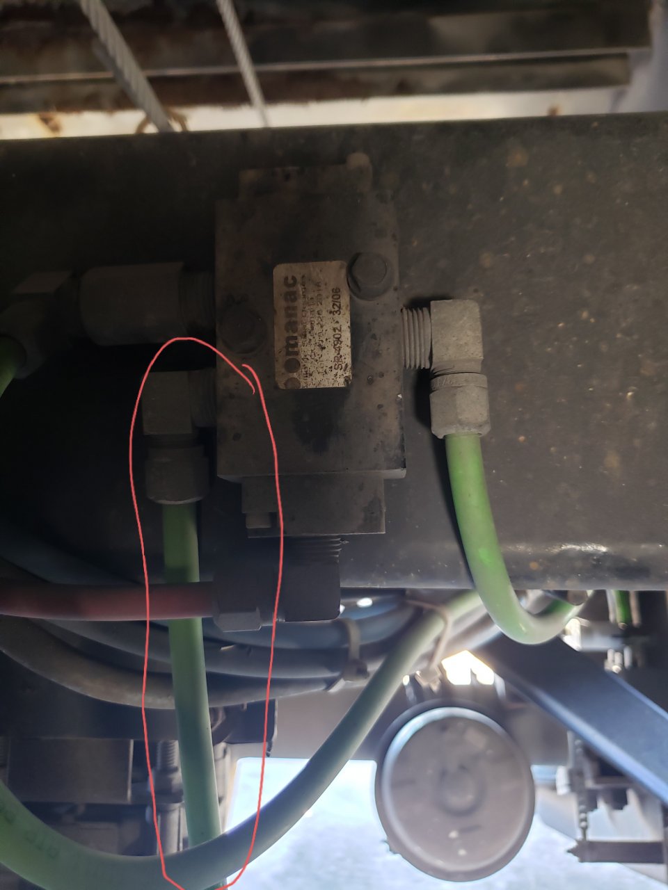

    I know what the leveling valve is and does, even when level it will leak from the exhaust, if I #### the truck off it will continue to leak no matter if air is going to the trailer or not. It will leak until there is no more air in the bags.
    Even the new leveling valve will.
    The pilot valve will also leak constantly from the port that someone attempted to cap off, looking at diagrams it shouldn't leak constantly. So I have a new one coming in to see if that changes anything.

    The valve in the tank is fine, I assume just illustrating where the signal line for the pilot valve comes from.
    The valve im questioning is in the first picture of that post.

    Few years late for an answer for your question, but those valves are added into the air suspension to dump the trailer suspension when the parking brake is set for loading purposes. They can be used for other reasons, but majority of the time they're used for that.
    It's basically a secondary control valve for your air suspension other than just up and down function of your leveling valve when the trailer has air in the tanks. They can be electronically or air controlled depending on the valve style you have.
