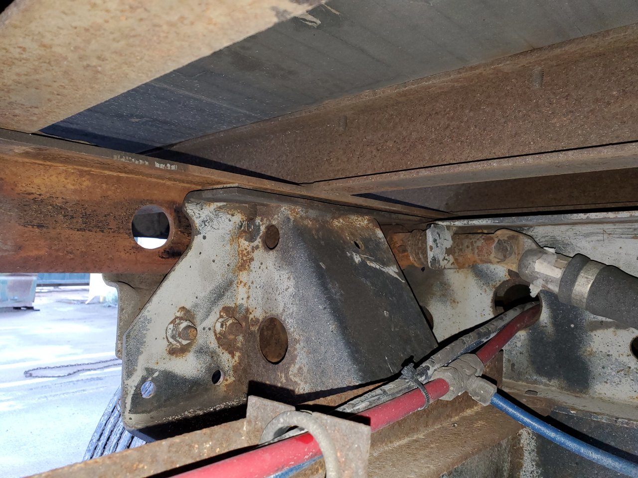

    I do see a plate up there. Maybe it's teflon, can't tell. Pins appear to line up, but I have to tease them with a flathead screwdriver to get them to pop into the holes.
    (Moisture trails in the 2nd pic are from when I tried some wd40 to help slide them)

    In the first pic it looks like the pins may be dragging on the rail. I’d spray all the guides and pivots for the pins with wd40 or pb blaster and work them in and out a few times. After a day or so go back and spray them with fluid film. Where you see Teflon plate can be sprayed with fluid film. I slide the wheels all the way back and spray the rail,then all the way forward and spray again. Any place you see the rust being knocked off needs to be sprayed.
