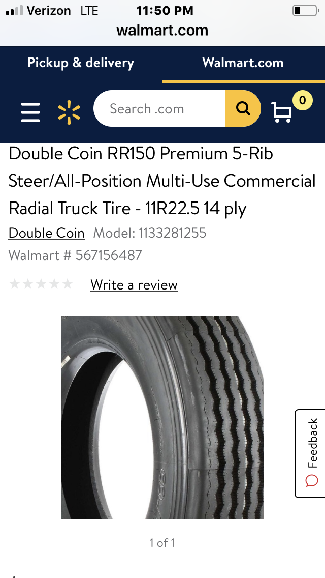

    Maybrook TA had road masters 8 for 2000 out the door a few months ago

    Well..Its True..."You Get What Ya Pay For". No Chinese Tires For Me. YMMV
