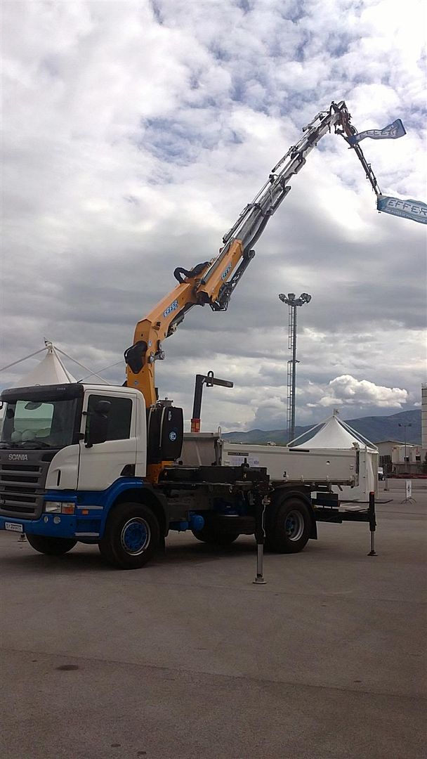

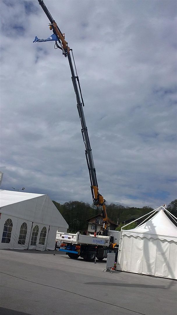

    now it is always question where to place crane, if you put it forward than you have very limited area where crane can work -only to sides, behind of truck you already lose capacity , above cab you dont have stability for max capacity...also on sides stabilisers are often obstructing you ,
    look at this little beast, effer 305 with 6x +4x on jib
    3 extensions are missing , could not catch it on photo there was no space to move back anymore
    if you have crane on behind , than you cant use tipper on rear , only on sides,except this very new thing
