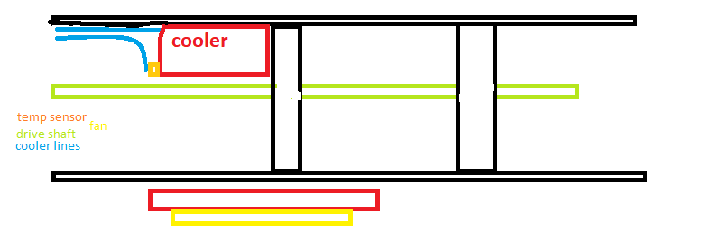

    I remounted my aircooled unit horizontally between the frame rail and the drive shaft behind the sleeper. A T-fitting for a temp sensor (210degees) to to control a fan blowing up helps a lot.

    I remounted mine for clearance and protection while running gravel roads north of the Alcan highway in Yukon territory hauling mining equipment. it protects from road debris as well. This can also work for him as a lowriding carhauler.

    Air cooled is supposed to be mounted in the front of the truck so air passes through the cooler when moving. The fan also pulls air through the radiator and ac condenser. If mounting the cooler like Beastr123 did (which is ok, worked for him) behind the sleeper then the cooler is not going to get anywhere near the airflow as if it were mounted in front. So in his case (or yours if you decide to do the same), then yes, a fan would be needed.
