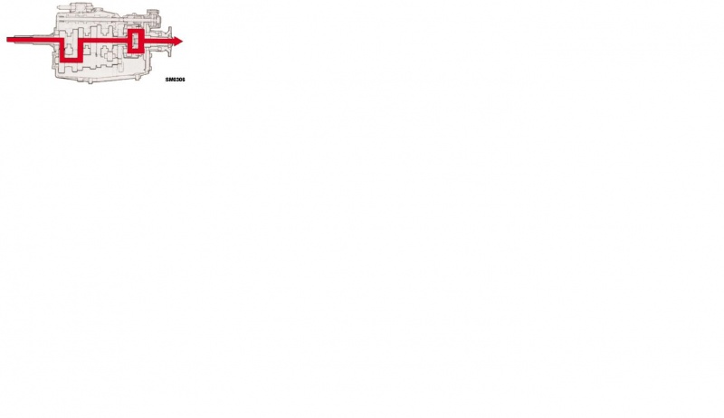

    Looking at the power flow diagram of the:
    FS(O)-6109
    FS(O)-6209
    FS(O)-6309
    FS(O)-8209
    FS(O)-8309
    It appears that the 1st and 6th speed share the same fork and gear on the main shaft so it looks like a synchronizer gear or ring may be the issue. Not sure, been a long time since I've ripped one apart. :(
