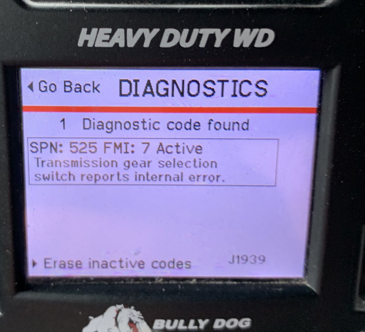

    From time to time when I’m trying to put the transmission into drive or reverse nothing happens and it just beeps at me
    It only happens when the weather is cold… And if the truck sits for 10 or 15 hours
    Sometimes when I’m in reverse and try to put the truck into neutral, once I turn the shifter selector button to neutral it stays in reverse and check engine light comes on
    The code is SPN 525 FMI 7
    It goes away by itself in 3 to 5 seconds and then it shifts into neutral
    any ideas?

    You may need new swotch assembly..

    If your truck is a 2014 - 2016, it will probably need a split pin bushing. That was a problem with early DT12.

    Theres some kind of "required maintenance" on these auto shifts,sometimes involving removing shifter case and adjusting crap. If I recall some cheaply made parts in there get broken easy. Fluids probably too thick at first. JMO
