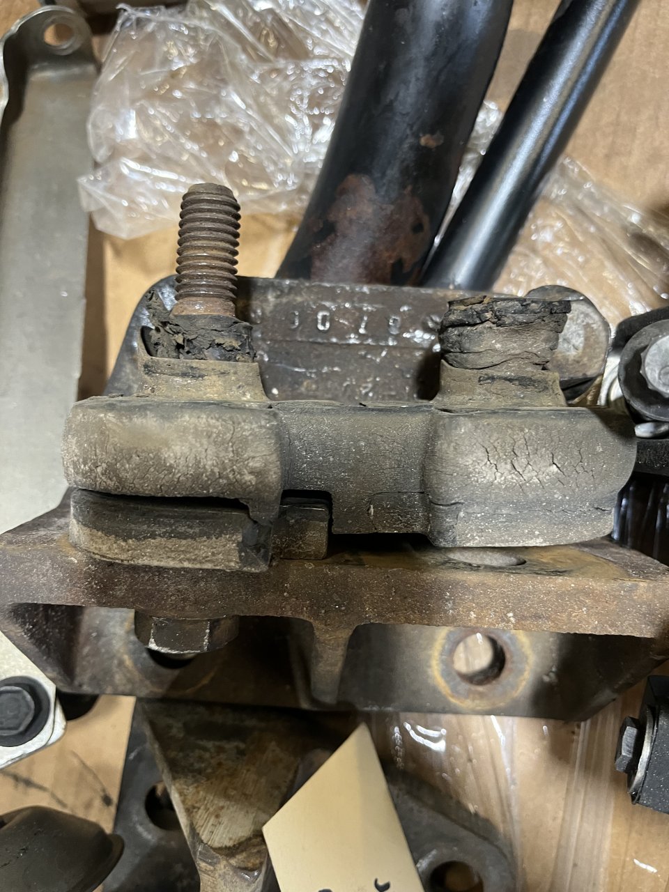

    Bad motor mounts? I just pulled these with engine. Well, they did. CC453455-EFC6-4FFD-81B8-3707459CEB55.jpeg

    Transmission been fixed by the shop who rebuilt it in September... The owner is very mean guy and never answered the phone until i got ahold of previous shop owner and asked for assistance. Long story short - shop owner said my driver doesn't know how to drive and sent me this pic from transmission shop , he said it will be on the house only because they have long relationship with the transmission shop . I ended up paying only for removal/install . Driver had this truck for 3 years and September failure happened because one of the transmission cooler brackets got broken due to rust , hose rubbed and lost all oil and literally fried the tranny ( no trans temp gauge )
