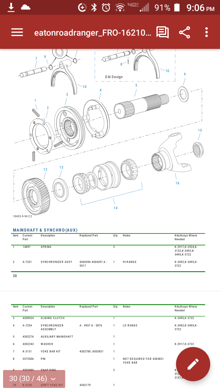

    Good evening to all. I'm having an issue with an eaton fuller fro16210c transmission. It does not matter what gear I put it in it's in high range (reverse included).
    I already changed air shift module, tired new shift knob, replaced shift fork plate with one from another transmission I had. I still have the same issue. I would appreciate all advice. Thanks

    Snap ring came off range shift bar, aux section and shift bar housing need to come off to repair.

    On the Eaton FRO__210 transmissions, the shift cylinder for the range is located in the shift bar housing. The shift cylinder has a spool that meshes with range yoke shaft. The yoke (fork) is held in place on shaft with two snap-rings. Snap-ring pops off and you are stuck in one range. Seen it many times. I usually pull the transmission and go thru back box.
