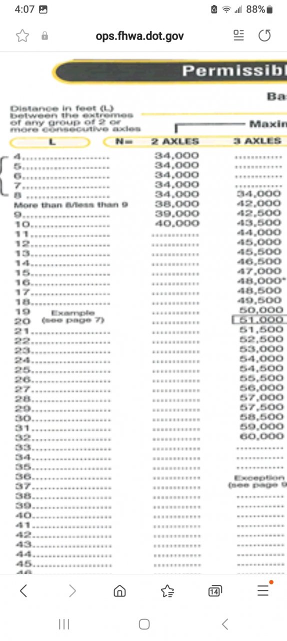

    I believe, federal bridge formula will limit a 4’6” axle spacing (so 9’ 1st to 33rs axle) to 42,500
    and a 5’ 0” spread to 43,500
    on the STAA system
    state by state May grant you more
  6. singlescrewshaker
    4,938
    43,408
    Dec 31, 2017
    Little Havana, FL
    Ding ding ding, We have a winner!!
    All depends on axle spacing, & some jurisdictions may allow you to permit for more off STAA routes..
