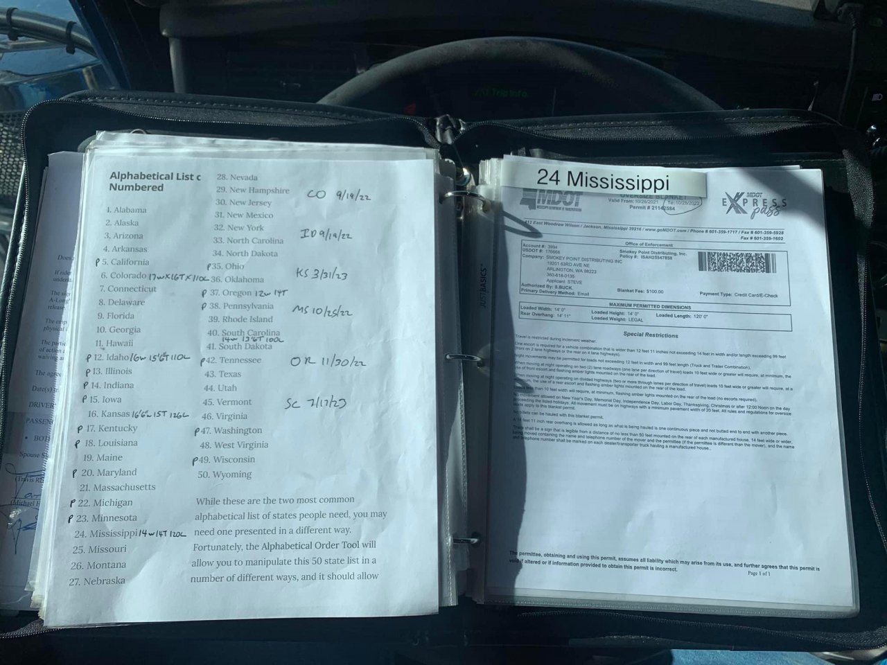

    I’m giving away all my secrets now:
    In my permit book, that I take into every scale house, I have a section for oversize annual permits and provisions. They are numbered in alphabetical order and if I have an annual the expiration date and dimensions covered are listed. The states that I have provisions have a “P” next to them. 9435EA78-AC7E-4A3C-A709-9B07E2DB1594.jpeg
    For the states that use counties for curfew I have taken a map and shaded the appropriate counties in.
    truckdad, CAXPT, FerrissWheel and 5 others Thank this.

    I say with tongue in cheek that you have 3 annuals that have expired according to your list.
    FerrissWheel, kylefitzy and cke Thank this.
