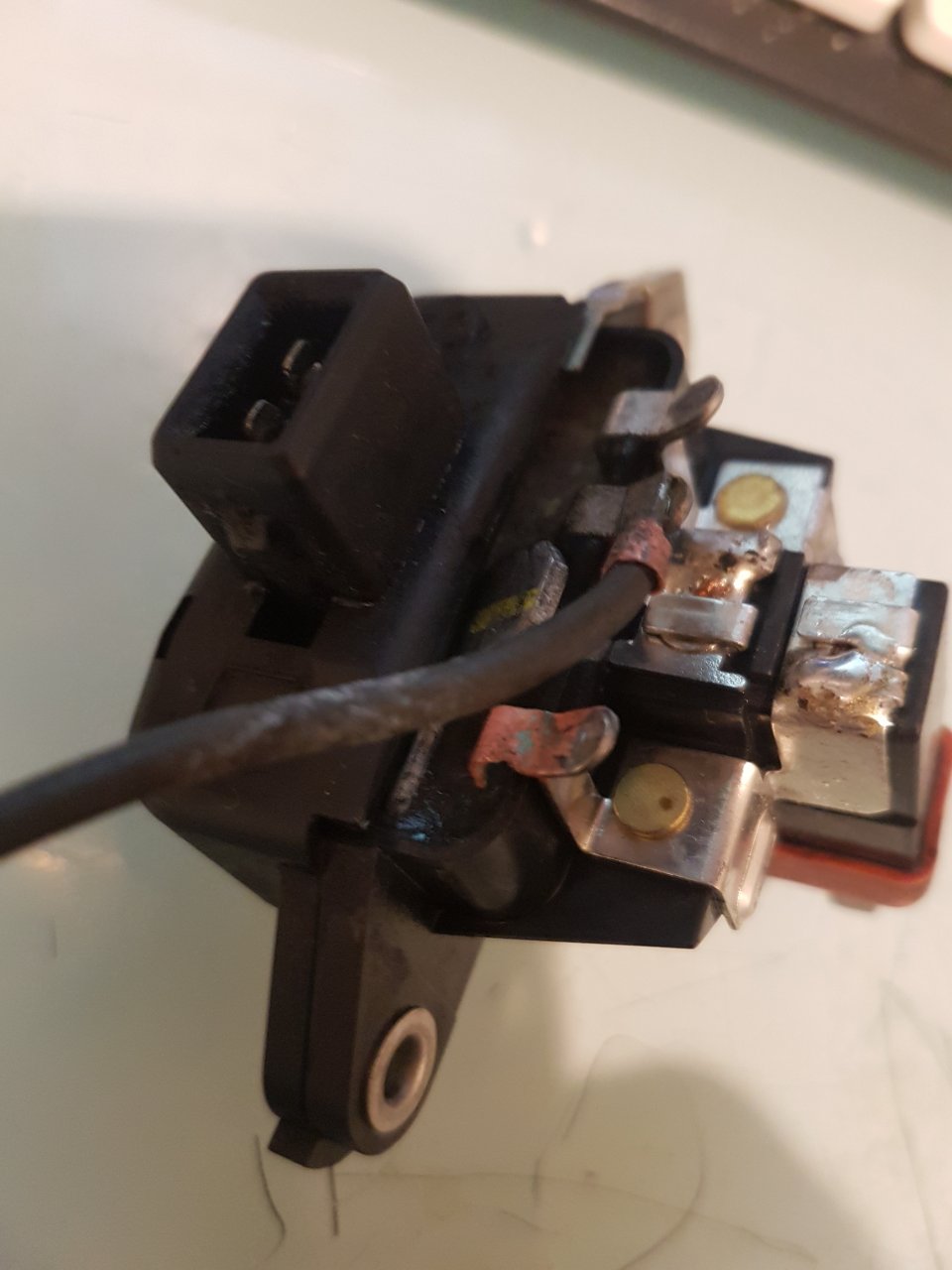

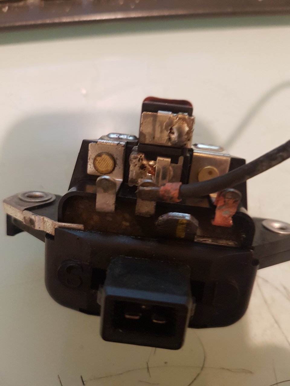

    on Dec 26 my tripac stopped working . it would run about 3 min and stop. ALT code was seen on display. Took the alternator out to check to see what is wrong. Its one year old OEM Bosch AL928N 65w alternator. I think something is wrong with voltage regulator. Ordered and installed Delco Remy OEM alternator today. Tripac is working now. I will attach pictures of Bosch alternator. I want to put new voltage regulator on it and test it. One of cavities of voltage regulator is corroded. Looks like it had high temperature. Any idea why it is corroded ?

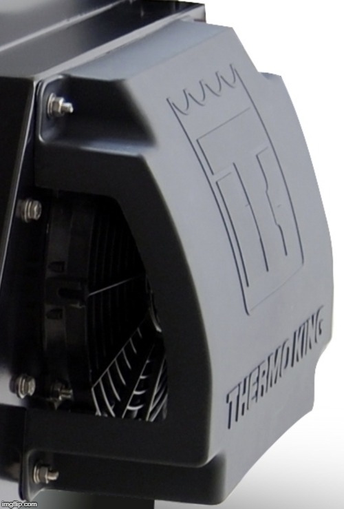

    moisture ingress, and road salt. Do you have that cover on the cooling fan?
    I was getting intermittent ALT shutdowns constantly (every other day) and getting dead alternators replaced every 6 months. Put the $150+ piece of plastic cover on after getting i think the 3rd warranty alternator swap and have not had one single ALT shutdown or issue since april 2019 (going on 9 months now, not one single ALT error, constant heavy hotel loads and AC simultaneously). Mine is mounted so the fan is facing forward, with enough space between the tripac and fuel tanks to basically allow whatever the steers and air draft kick up water/snow/mud/sand/salt to get air blasted straight through the fan and into the tripac box. not anymore...

    I have that cover...

    the spare part number is IB392 for bosch or bosch style alternators. $22 on ebay
    Friend of mine gave me used non working original tripac alternator. I removed the voltage regulator and I saw brushes are worn... so if your tripac alternator stopped working after 2-3 years, check the brushes. Set of new brushes will give another 2-3 years of life to alternator.
