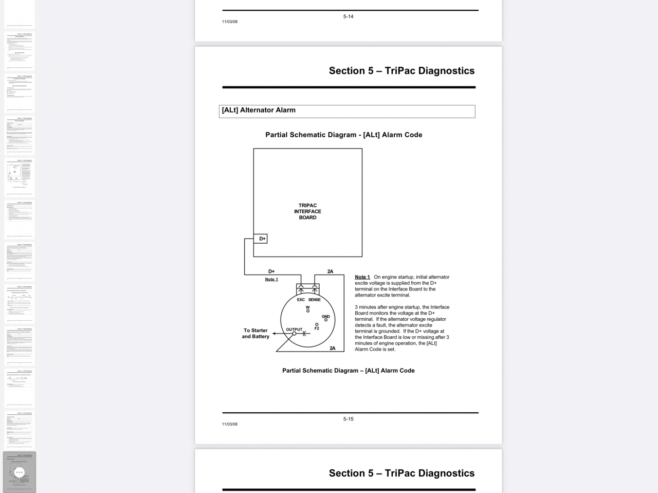

    there are diagrams out there I have one that’s on a older version I’ll post up in a bit

  3. LoneRanger
    LoneRanger Road Train Member
    3,695
    9,607
    Jun 3, 2018
    Your issue was right here i think, since that looks like it was the sense wire on the starter. Because that sense wire goes to the starter, it was grounding out and throwing the code before it even started.

  4. D.Tibbitt
    22,863
    158,096
    Yes that would make sense.. The wire at fault has a 3amp fuse on it right before it hooks into the starter... power to the wire is supplied off the postive battery cable.. I looked for any writing on the wiring itself but couldn't find anything
  5. LoneRanger
    3,695
    9,607
    Jun 3, 2018
    If in fact that is the sense wire on the newer versions it’s wired directly to the battery. Not jumpered off the starter. So as to not cause this kind of confusion.
    If you want pm me your email email I’ll send this pdf off to you. It’s a good starting point. I used it alongside of images from google to fix my issues.

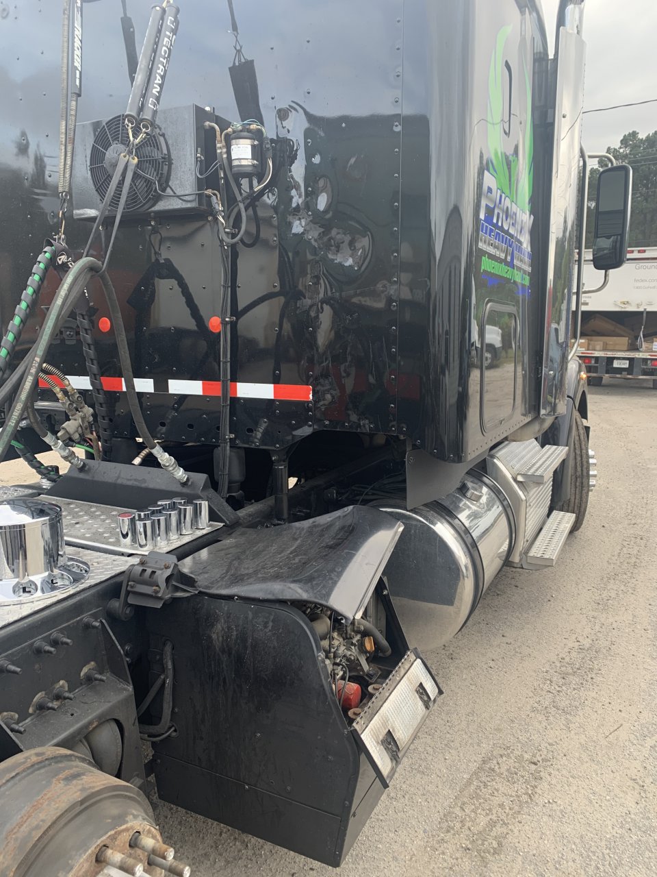

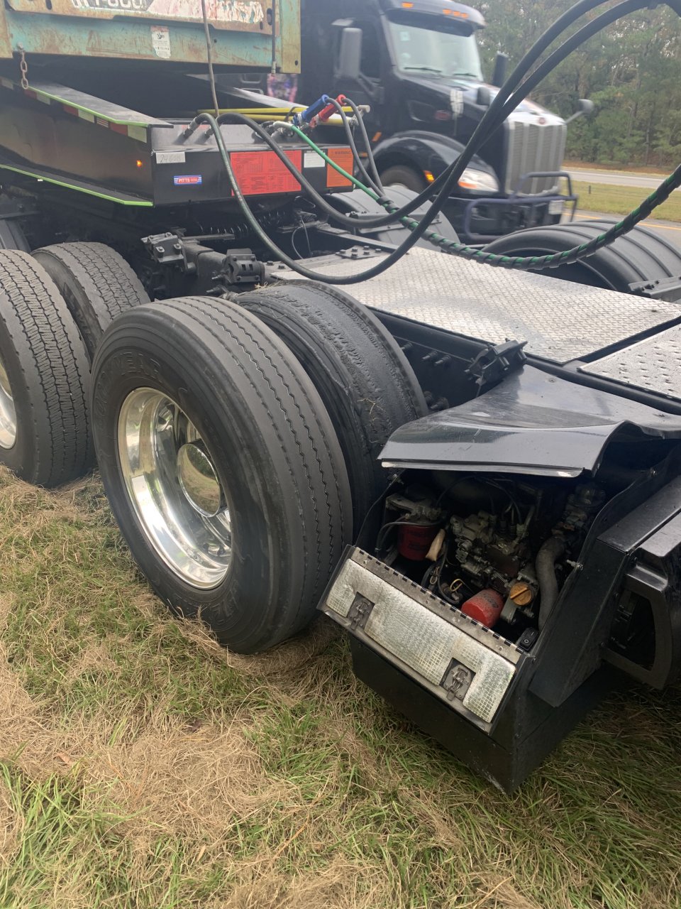

    Got 2 of my fenders and back of cab as well. 55CFE660-70BC-477D-8049-CB916CC76FDA.jpeg 2FDC4435-465D-4263-BEB4-66C68148F2C1.jpeg

  11. InTooDeep
    4,981
    37,364
    Jan 17, 2016
    Carmichael CA
    Oh man that sucks out loud.
    D.Tibbitt Thanks this.
