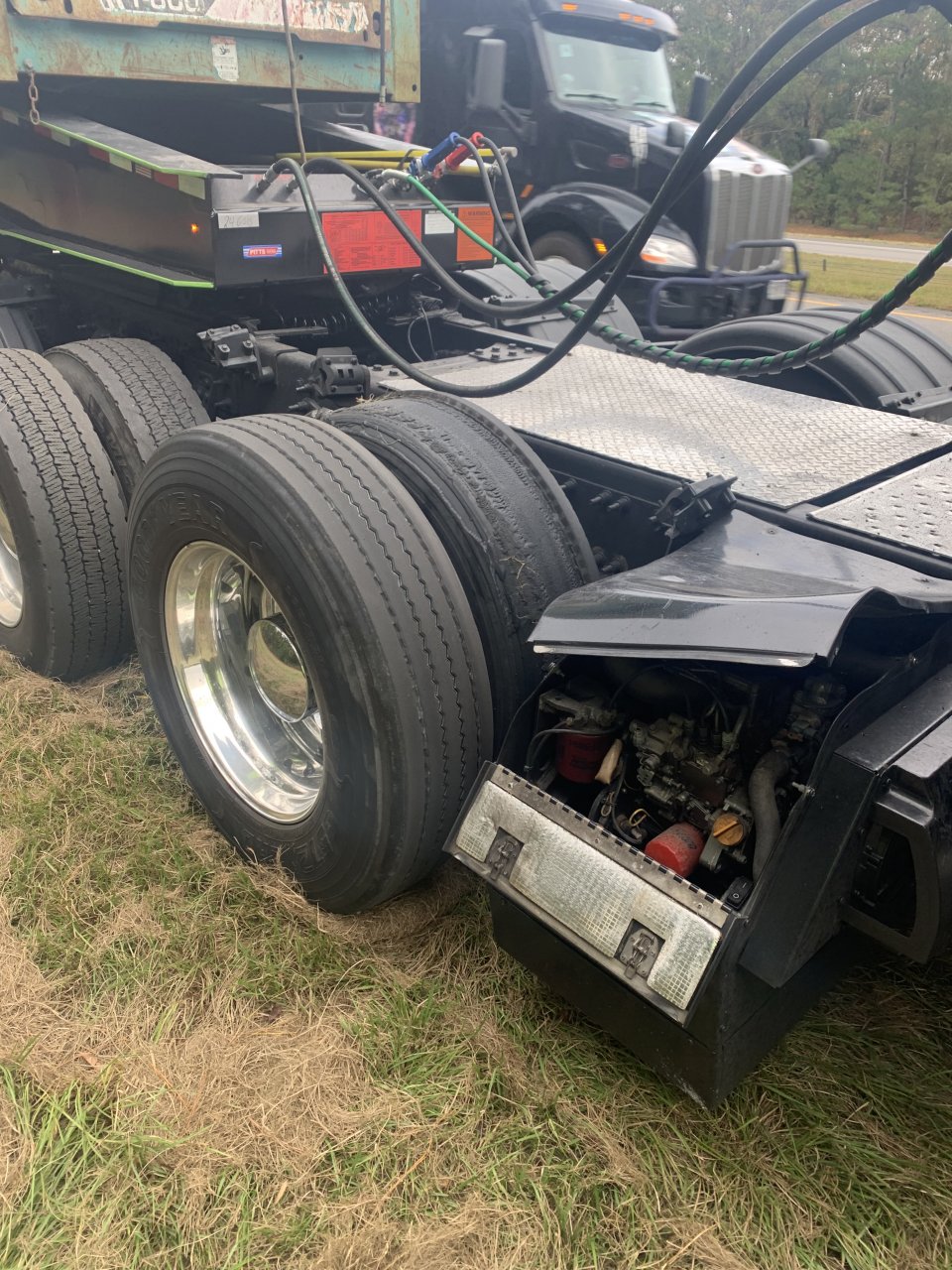

    #### man that’s rough. I was afraid of that as well, had to install quarter fenders.

    That’s sucks and it looks like your tires are in good shape
    Maybe now you can just turn it into the insurance and get the truck and Apu fixed at the same time

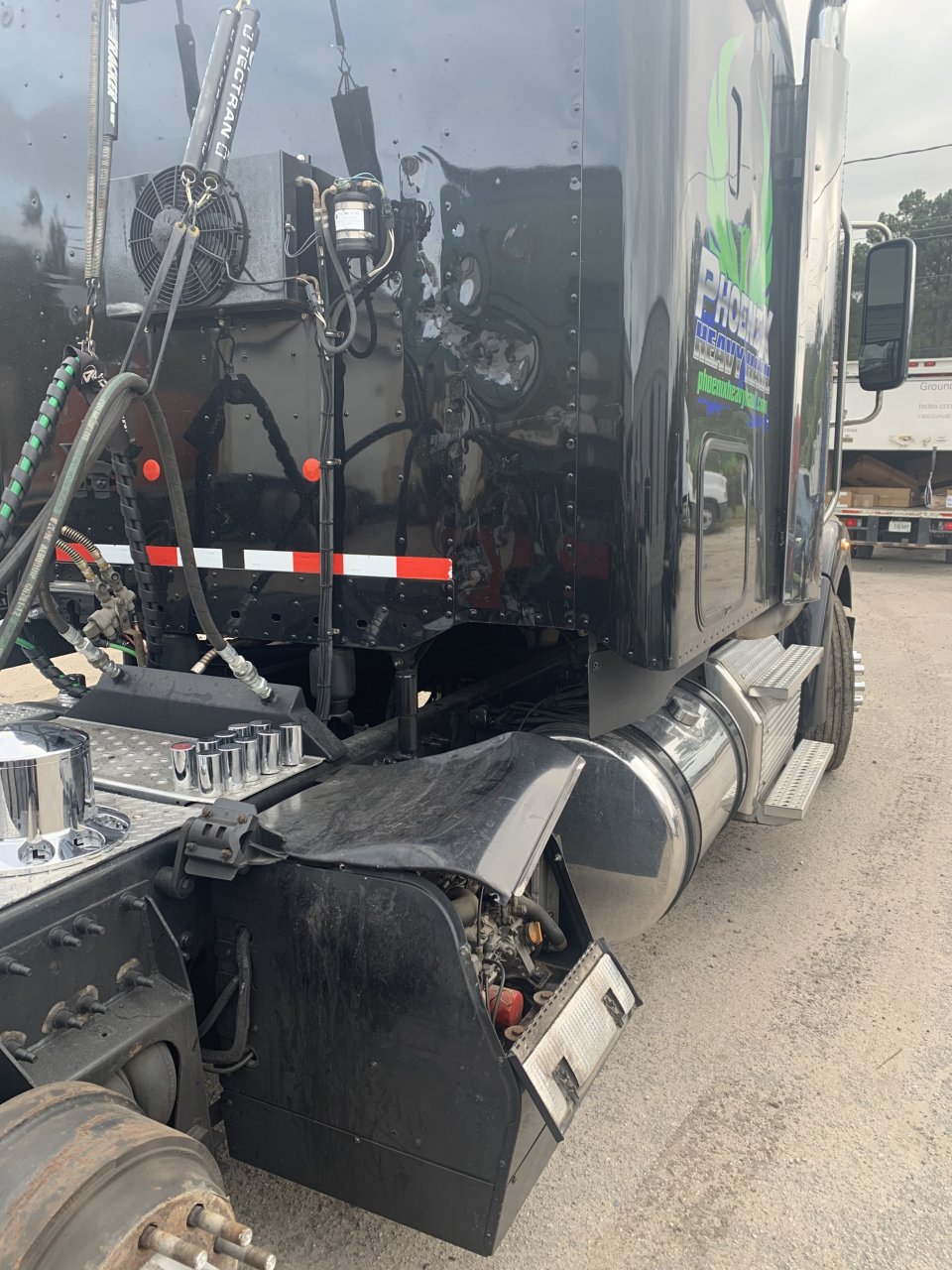

    Ouch! Same thing happened to me six month ago. Fortunately with a TK each one of those housing panels are individually replaceable. The tire also took out the intake air filter housing on mine. Had to go to three different TK dealers in three different cities to collect all the parts, but it all went back together easily.
    FYI These guys ship same day if you want to get some extras or replace some buggered torx heads.

    Awesome thanks! I was hoping I could buy the panels.
