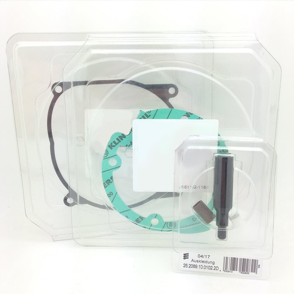

    I took the truck to TK in Dallas, they wouldn't work on any of it. They said they "tightened connections" on the batteries of the truck. It did the same thing when I got it home Friday. It kicked on a couple of times presumably when it needed to charge the batteries. Went out yesterday to check, and the batteries (Sunday) were again low. Alarms going off in the truck, but still had enough power to start the truck. So I started the truck, then turned on the APU in a/c mode, with it set to 50 degrees. Went out last night and the APU was off with just the fan blowing for the a/c. I have heard the APU run though several times since I have had it set on a/c. TK insists that the wiring is "old" but offered nothing whatsoever to remedy it at all other than suggesting buying a new APU, or a new bunk heater. The bunk heater is what I took it in for to begin with. The service manager insisted I had the old D4 Espar heater, which it isn't. It is a D2, says so right on the dang label on the cover of it. But attempted to try to sell me a "new" D2 heater to the tune of nearly $1,900.00. The service manager claimed by the time they pulled out the heater to replace the atomizer screen, and put in what he kept referring to as a rebuild kit, I would be a couple hundred shy of buying a new heater anyway. And then claimed they didn't have any parts for the D4 heater, which again I don't even have. Almost like they just didn't want to do anything with it cause it is old, and has some dirt on the wires.

    I am telling you man, they just don't want to get dirty. For mechanics, the guys at that TK shop look like the cleanest mechanics I have ever seen in my life. I think they really just didn't want to do anything. They ended up not charging me anything at all for what they say was tightening battery cables on the batteries. They weren't loose. They moved some cables around.
