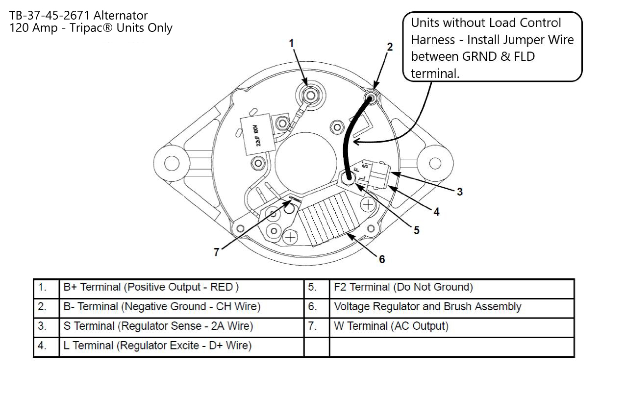

  10. 062
    062 Road Train Member
    6,346
    34,006
    Oct 20, 2013
    Is this roughly what the back of your alternator looks like?
