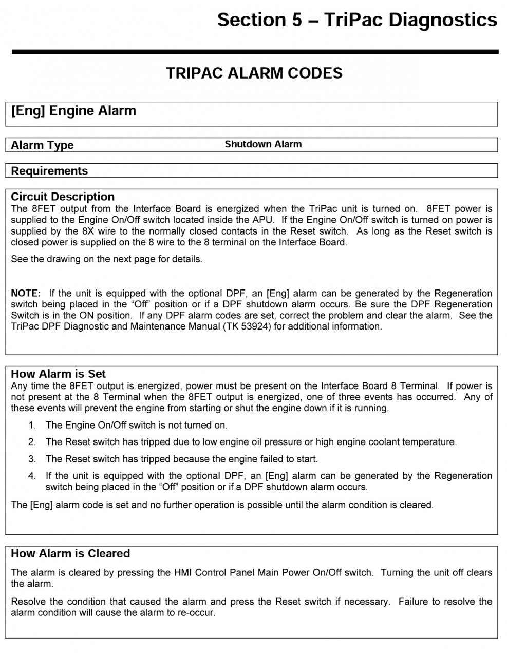

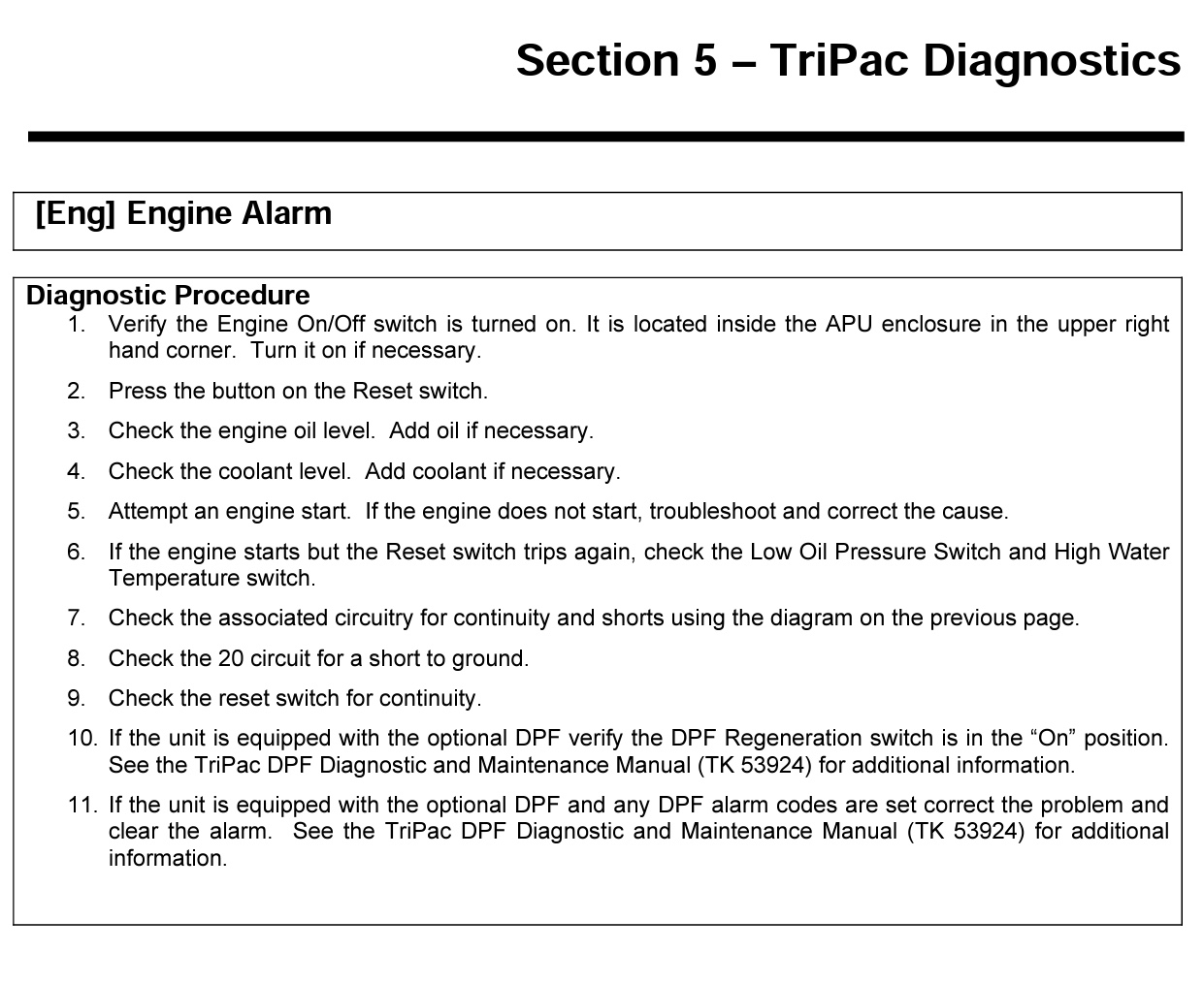

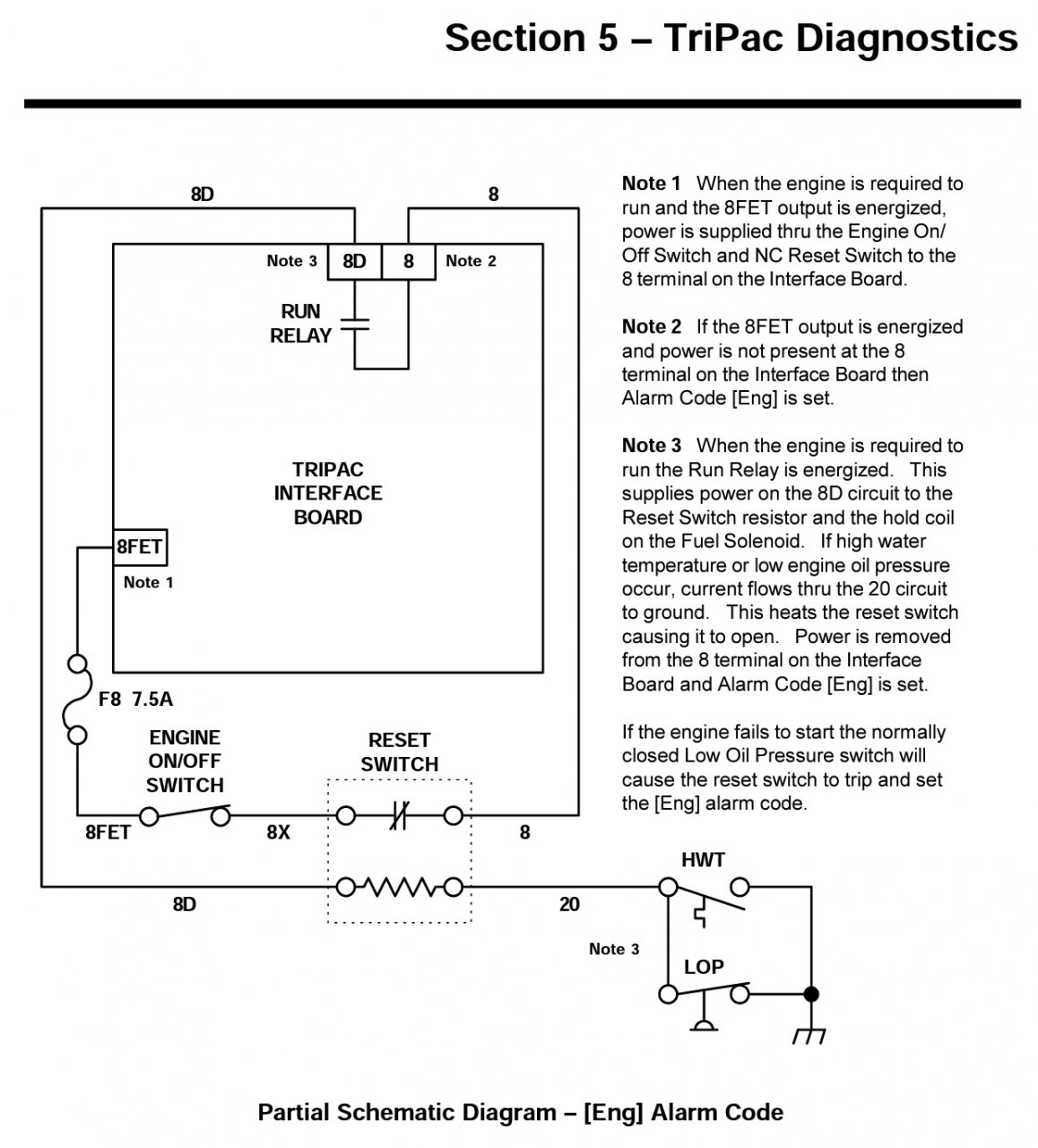

    Here are the diagnostic procedures for the ENG code on the old model Tripac. You have a Tripac Evolution, but it may still be helpful.

    So when the APU stops working, what am I checking at exactly to see where theres a short.
