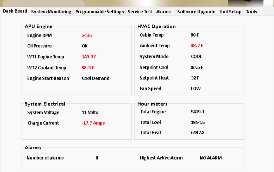

    [​IMG] So where can I get a clean download of the software update?
    Has anyone recently updated that can paste their files so I can replace it in file explorer?
    I keep getting corrupt errors when running start.bat
    I have the software from a third party site, wanted to know if negative charge current is a no go, the APU doesn't charge the battery. When I cut off the engine and start the APU, the APU drains all the battery until there's no battery life left. Alternator and connection is good.

    When I charge it, the charger reads 11-12V, so I don't understand why it's -0.2 when the alternator is good. The red triangle keeps showing

    So what can I do to stop this from shutting off and giving me ALT code, the alternator is new

    Will a replaced alternator help the APU charge the battery though I honestly think it’s a board or sensor issue

    The system voltage shown is the voltage being read from the battery, not the voltage output from the APU alternator. The negative charge current indicates the APU alternator isn't charging at all so there is no voltage from it. Don't return the new alternator just yet.
    There is a post on the alternator that has two smaller wires connected to it. One of those wires is the signal wire from the control unit telling the alternator to start charging. I recently had the exact symptoms you are having. It was with an alternator that had just been replaced a week earlier. Turns out one of those wires was broken. Makes me wonder if the old alternator wasn't bad after all, even though the wire didn't seem to be broken at the time. Expensive mistake if so.
