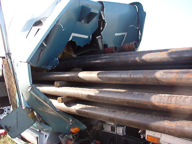

    Do you guys think a stack of 4X4' would have done anything at all to help this situation?

    Nope if you look closely, this guy had one on the back of bunk

    It would help about as much as a stack of match sticks.

    looking at the picture above with the pipes, Looks like there was a Headache rack at one point. Clearly the sheer mass of the load moved through the cab.
    Not to be harsh regarding these accidents, but, there are cases where seat belts don't save lives. The only think I believe that could have stopped the load from moving forward is to have more securement on each layer of the load. simply having straps or chain on the upper level doesn't supply enough pressure to stop the lower portion of the load from moving. With loads that can possibly move, I like to put 100% or greater securement on the load to help prevent this from happening. IF the load weighs 35,000 lbs, I like to put 35,000 lbs or greater of securement on the load. I don't want it to move. I guess being scared of the load also gives the load respect.
    Given this is pipe, are they oily??
    If so, then no amount of securement could have stopped this from happening. Only driving with your eyeballs constantly watching for others and driving like you are carrying a load of eggs in a bucket is the key to getting this load to it's destination.
