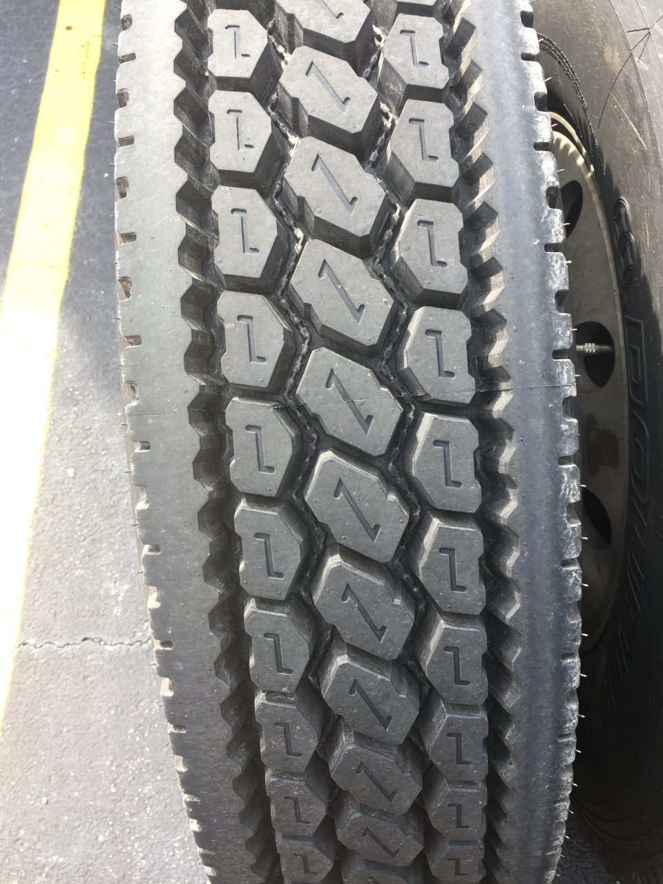

    F595F014-0A31-4E8E-8408-9168901F9B80.jpeg LOWered tire pressure to 90 psi still same feels like my drive axle is separate like trailer even small curves and turns just sway fishtailing so scary feels im going to jacknife and driving on icy or slippery rd

    The tread pattern looks a lot like the Yokohamas I installed last December. I never had anything close to the OP's experience.
    One thing I did was have Centramatics put on all the drive axles. I did that because of the bad cupping and hopping on the mismatched set of drives from when I bought the truck. The ride and performance from day one has been great. The tires are wearing evenly.
    I did have new leaf springs installed on the steer axle (adding an extra 3/4" shims to the right side) along with a three axle alignment. Since then steering has been neutral, when it used to require hard left pull to stay straight.
    I run my Yokohamas at 100 psi.

    How deep is the new tire tread? Brand new 1 inch tread depths are real icy feeling for about 40,000 miles. This what I've been told by a coworker who had brand new good year 632 or 562 model tires. Most new smart way tires are 22/32 tread when new.

    My Yokohamas were 33/32" to start. I never felt like there was any loss of control when I first started driving them, rather I felt far more stable.
    I'm thinking his fishtailing (which I had) might be related to his suspension system and alignment. But the OP already noted he had not one, but two alignments and added work.
    OP, how old are your shocks?
