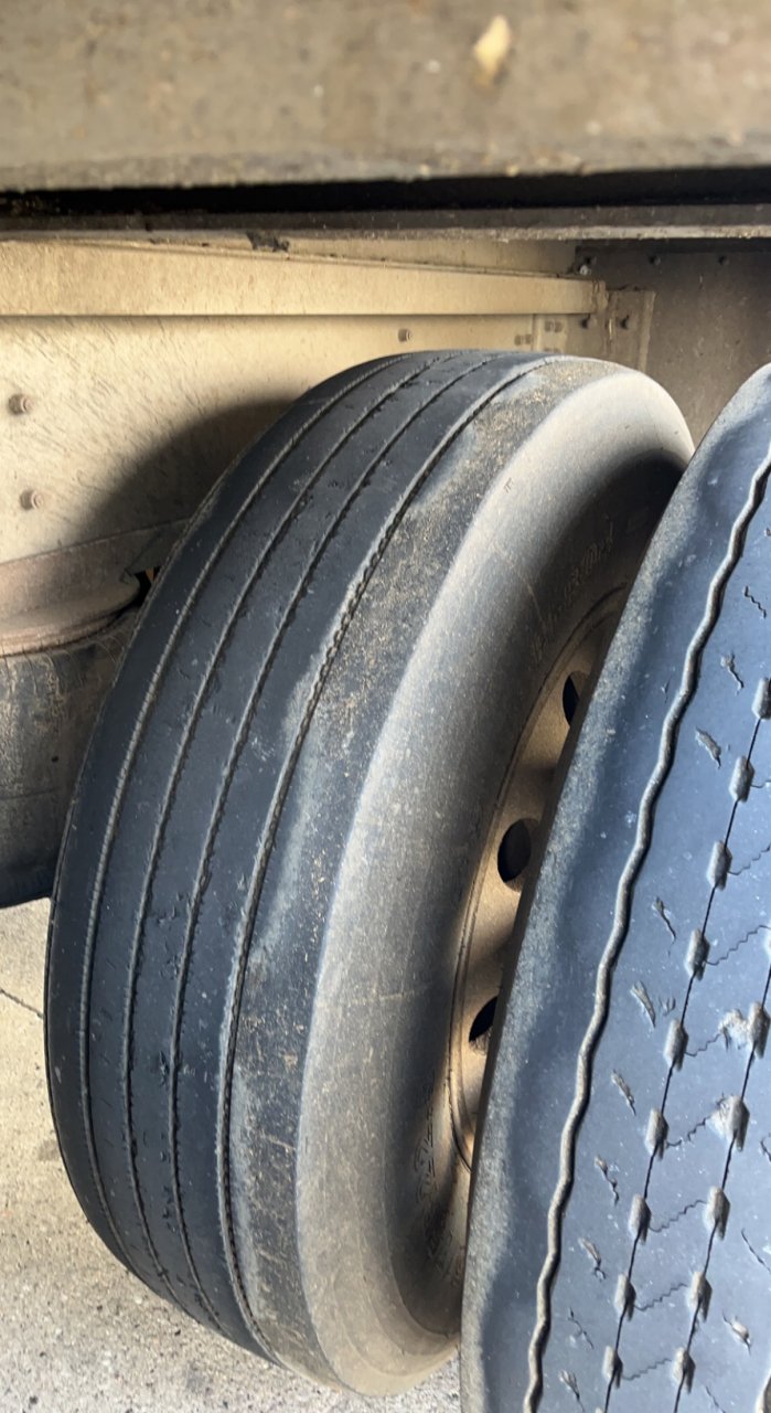

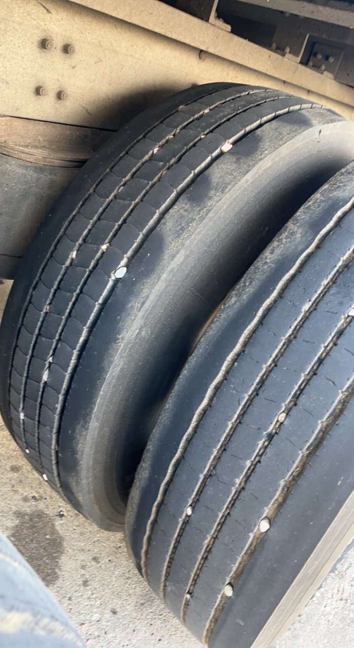

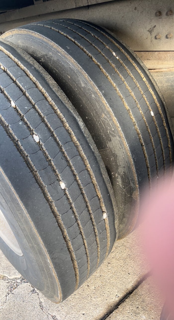

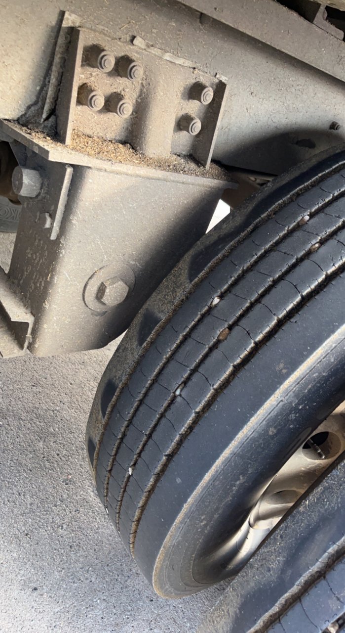

    Here’s pictures of the trailer tires. I’ll have to do that. I’m just so dumb founded that it only started once I started pulling this trailer. And when I’m getting up to speed to 30 mph that just started today. Otherwise it seemed like it was only at 60-65mph when it would shake. And it would shake the whole cab. I could hear everything in the sleeper shaking.

    I would check the air pressure in the tires,might be over inflated.

    Are they all old steer tires on the trailer?

    Tires are all at 100lbs. When I picked up the trailer there was a few tires that were only 40lbs. Rest around 80. I think 3 of the tires are steer tires
