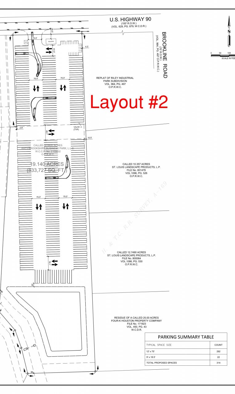

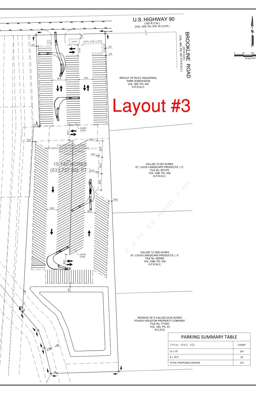

    Hello Everyone,
    Wanted to create a quick post of three (3) different layouts for truck parking. I'd like to know which option you prefer and why you prefer that option over the others. This lot will be fully concrete paved with climate controlled showers, climate controlled restrooms, truckers lounge/breakroom, and other amenities. However, if the layout isn't ideal then none of that other stuff matters. Would appreciate your input!!!

    Go with option 2 - square the spots up.
    With angled parking some one always goes too deep or too shallow. When blind side backing in, any one parked wrong is going to make it challenging.
    With 75 feet deep spots and 75 feet innnthe exile, you can get away with 11.5 wide spots.

    With angle parking, avoid blindside backing. I like option 3, but I would like to see the blindside reversed.

    Same. I like 3 but make it see side

    For Option #1 The angled parking near the entrance has the driver doing a blind-side back into those few spots. That often leads to either more backing accidnets or more pull-in parking and blind backing to leave those spots. I like option #2 for the fact all parking is alley dock parking.

    This also. Why not have most of it sightside. It might alleviate some trailer damage.

    I prefer option 2, standard parking spots allowing directionless travel.
    If the site has angled parking, as others have mentioned, the blind side spots should all be changed to sight side.
