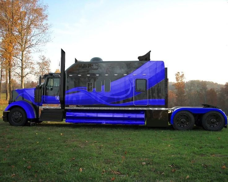

    See that's what i always wanted to do for a rv...
    Duncan Rider Thanks this.
