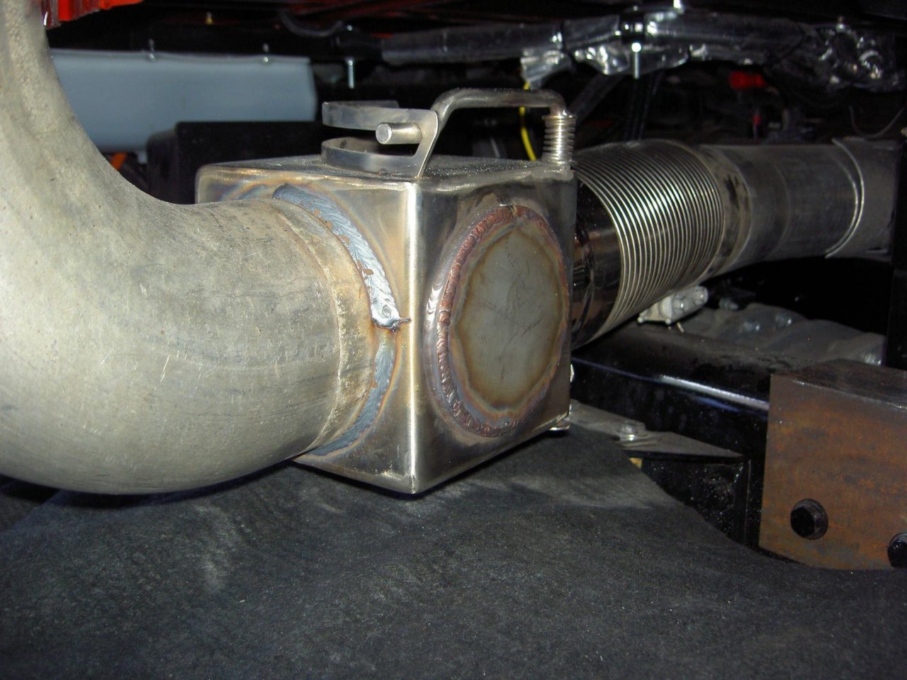

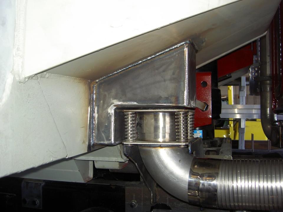

    FD584FFC-656F-43D0-9096-C135E22771F3.jpeg 7AE0223E-3D5B-4437-8037-375B66CC7824.jpeg
    This outfit is owned by oldcastle......

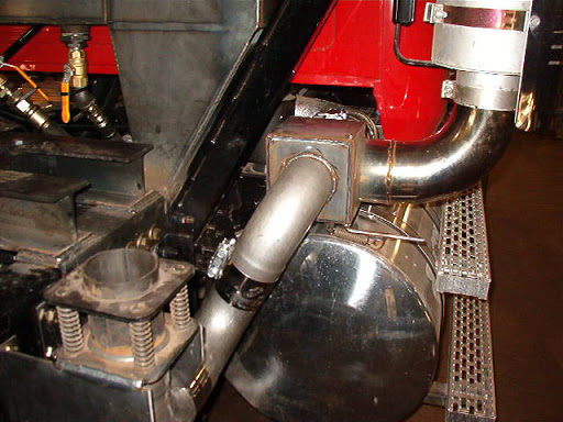

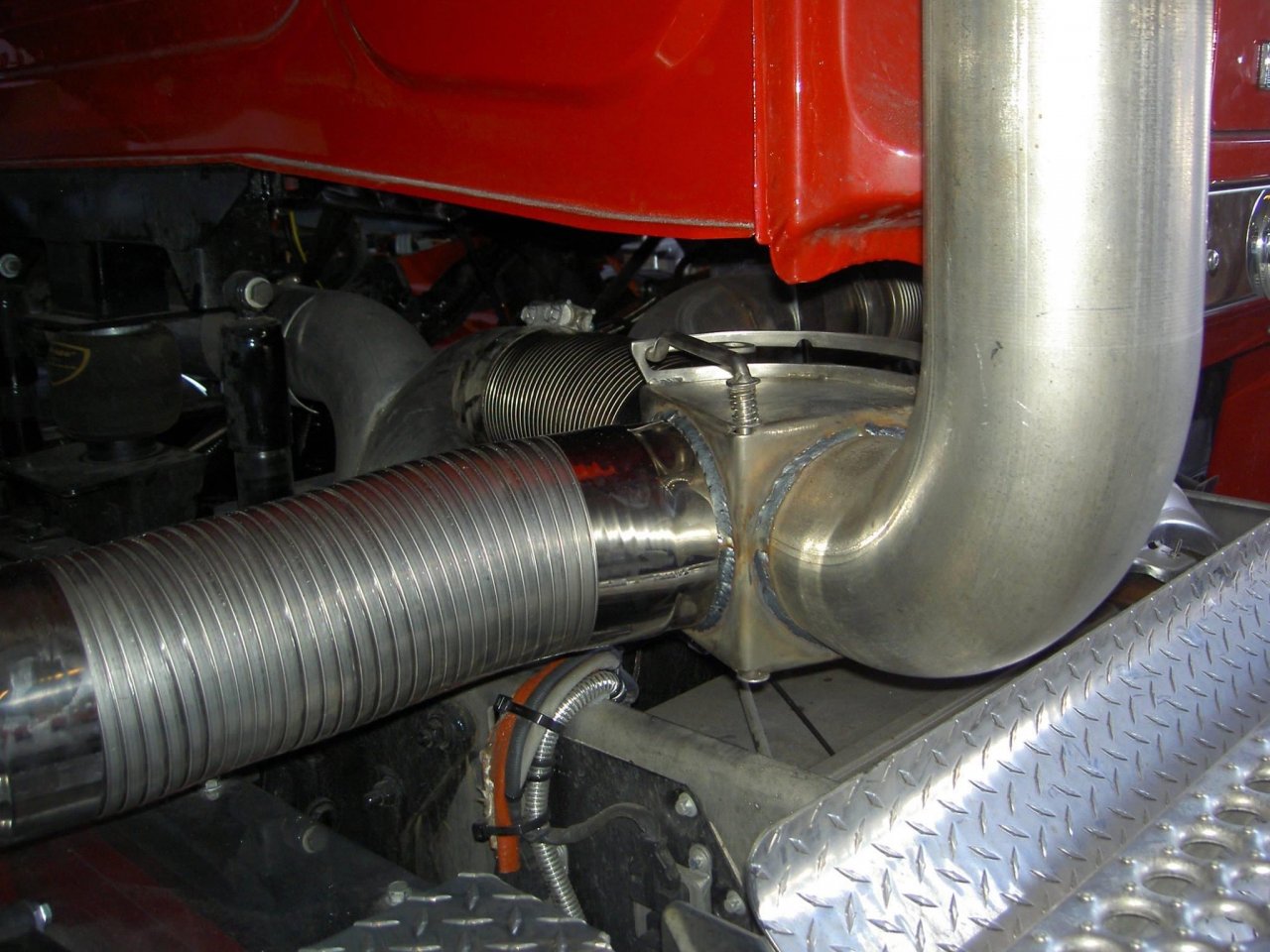

    Some guys not many have exhaust routes threw dump bodies to heat load... even new dpf scr trucks......

    Pre emission engines in Germany were routed into the bed.
    Now no more.
    FYI those were semi's with the exhaust blowing into the bed when they drove straight.
    In turns it was not connected.
    Tube was around the pivot point on the fithwheel.

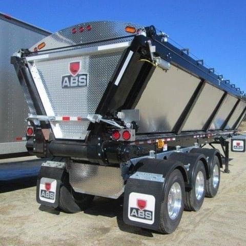

    Even for gravel they're becoming more common up here.
    This is what comes to mind when I hear the term "Dump Truck." Clean and simple. No goofy looking lift axles or steerable pushers. Nahanni dump box is probably the nicest looking box on the market. Pretty common out west since they're fabricated down in Langley.
