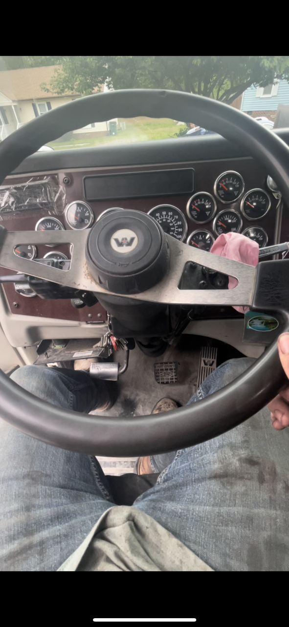

    I have to turn the wheel till the hand brake screw if covered before it starts to turn right
